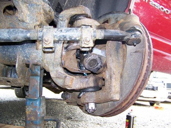

BTW, what did you do with the brake calipers? Did you remove them or did you just tie them up somehow?
If you look closely at picture # 1, you can see that I hang them from the upper arm. I just use wire ties (several) or sometimes just a rubber bungie. Make sure that you use something substantial to hold them, I think that they are heavy enough to damage the hose if they were to fall. :{
Also take and wire tie the tie rod up so that it doesn't interfere with the process.
