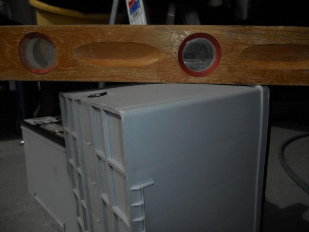

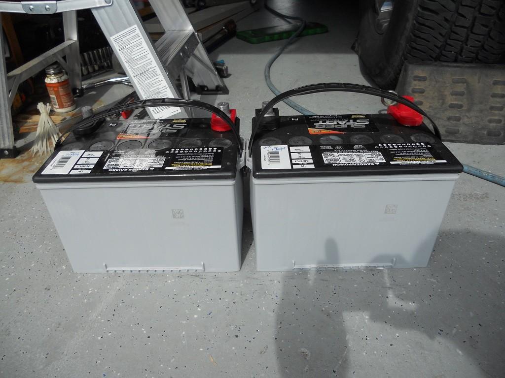

top quality AGM made by Decca
Heat is their only weakness. Testing one the voltage drops then comes back up. I quit testing and considered the battery dangerous to test again. FWIW Deka AGM even failed Consumer Reports heat testing. Didn't make it one year: July '14 to May '15. 90% sure these were relabeled Deka. The case bulging on both was impressive.
While I don't look at the Lifeline's in my camper often (in the TT they were installed in 2014 and not seen again until spring 2020) I pulled them out with impressive case bulging. It was gone then next day thou. I did a little research and found it was normal. The vents on them aren't open normally and take a pressure differential to open, so some bugling is normal.
Yup...too true... heat also kills AGM batteries.
