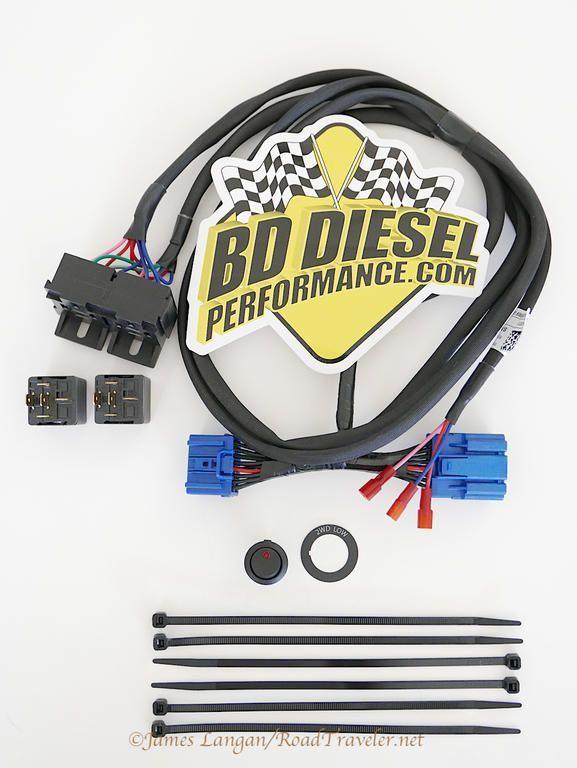

BD Diesel Performance 2wd Unlock Kit review

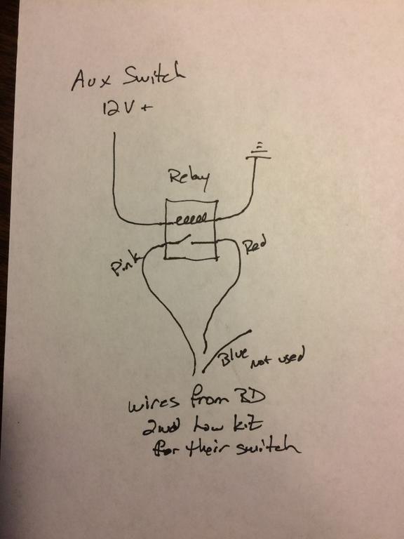

Got the kit installed - very easy to do. I also installed another relay in place of the switch. That relay is controlled by one of the factory aux switches so NO HOLE was cut in my brand new dash.
Works like a charm.
I'm soooo happy that BD came up with this, that way I didn't have to cut into my new wiring harness to create my own system!!
Glad this works, I have an '18 on order and I really liked 2wd low on my '98. So since I can't play around with it, how did you make the aux switches work? I was understanding that the aux switches were a ground output, momentary or latch on, but then someone here just posted they are positive output. ...so confused
Anyway while I dream of my '18 do you have a wiring diagram sketch you can share as to how you wired in third relay?.
I will attempt to get a schematic drawing for you. I should have plenty of time to do that in a couple weeks since I am scheduled for back surgery, and currently just laying around in pain.
However, for the 2016 I went to ram bodybuilder.com and download it all sorts of stuff they had on how to up fit the truck. On the 2016, the switches are a positive output. They can be controlled by the computer to either be battery controlled, or switch controlled as an ignition switch. You can also control whether it remembers that it was on, or defaults to off when the key is reset. When I get back to my computer I will try to find what I am talking about.

I too am interested in exactly how you wired the BD 2WD Low kit to operate off the OE aux. switches. I love using 2WD low, and it would be fantastic to operate it using one of the OE aux. switches instead of using the provided piece.
Here is a pic of a basic wiring diagram of what I did for the use of the Aux switch. Hopefully that helps folks out!
Hmmm. Just want to BD's website. Downloaded the latest instructions. They've updated it to tell you how to use your standard auxiliary factory switch. Cool! What a great company
