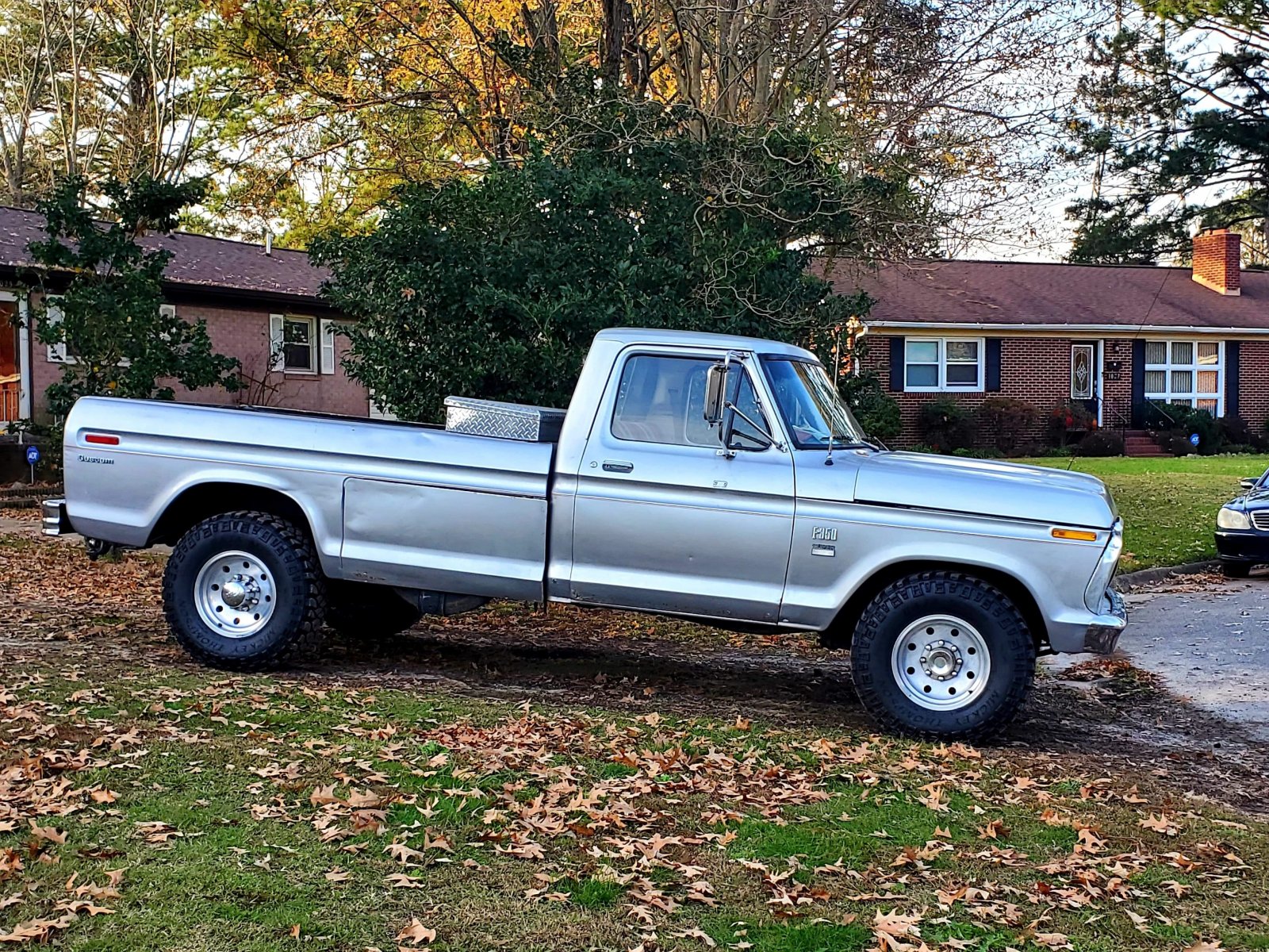

It’s the distance from cab to Axle Center that counts most for load carrying. Length & Height. (Cube).
Even Ford figured it out
https://www.hagerty.com/media/car-p...er-specials-are-rare-unusual-and-still-cheap/
Significant load rearward of axle center worsens risk on an already unstable vehicle as centrifugal force multiplies that weight. 10 becomes 100.
The frame is also not designed to carry weight without support at both of its “ends” (axles). What’s beyond the axles are only “extensions” (how to think of it).
Ideally, the engine would be farther behind the Steer Axle.
A pickup is a compromise. An old, bad design for modern use given the HMMV is now fifty years old and better conceptually for on & off road general utility.
