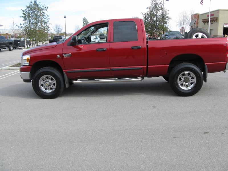

Just having installed the 285-75 17 tires and Centerline wheels, I'd like to level up the truck. I looked at the Tuff country 2" lift kit and it seems to be a good choice. I am also looking to rplace ALL the shocks with the yellow and blue Bilsteins. Does the 2" lift screw with the steering at all? Is the PITMAN arm dropped enough? Anything else that I need to weigh out? Best kits under say $200.00

Motorhead, That is a very sweet looking truck, Good Job! Jess

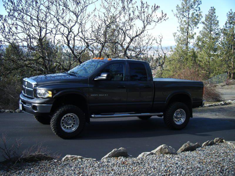

I started off with a 2 1/2" Daystar level kit, then added airbags for above stated reason. Then I wanted 35" tires without rubbing...did a 4 1/2" Tuff Country lift, hooked up my 5th wheel, crap, even with airbags back end sagging, had to add 2" round spacers underneath the airbags. Now 5th wheel does not have sufficient clearance at the bed rails and does not tow level, had to install the Dexter spring pack kit to set axles underneath springs, you know the rest...
Here's a pic of my truck, I believe it looks nice, and it drives decent, even towing, but I sometimes wish I'd never slipped down that slope!
Jess
