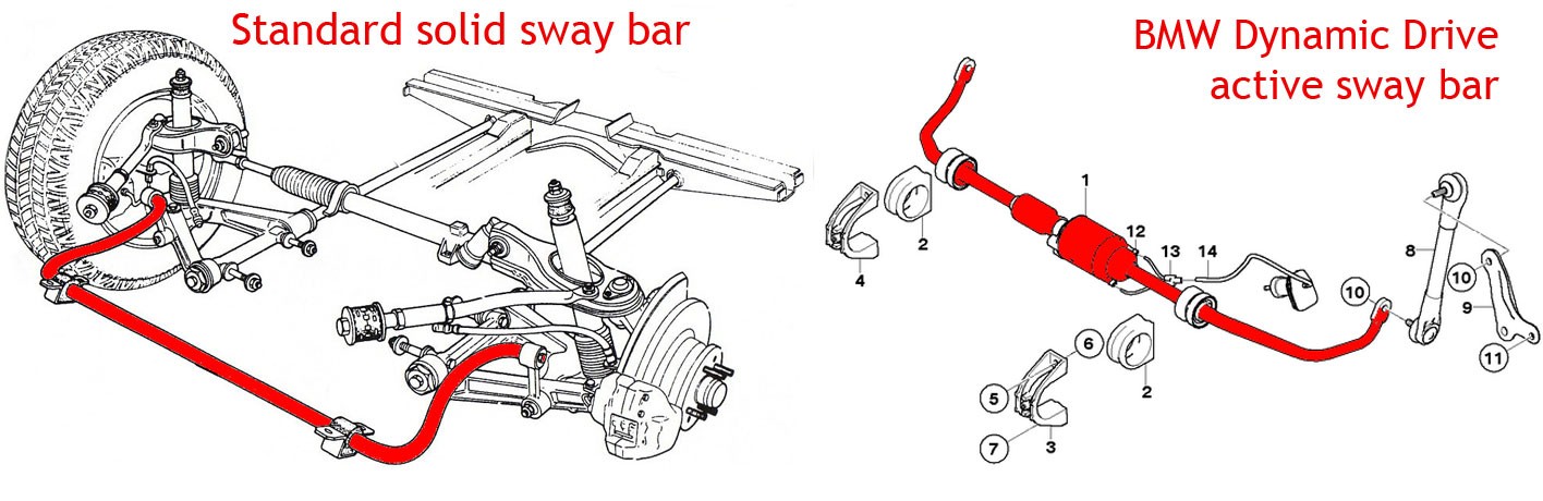

how is that Thuren can call this sway bar "active" ? I just looked up active sway bar which I now understand to be a sway bar that can dynamically change the relative position of the ends via a motor coupling in the middle like this illustration
Because it is more "active" then the stock one that is simply a rigid bar with less then 1" flex side to side.
The Thuren allows much more independent wheel travel and therefor a more comfy ride - without sacrificing stability in corners.
By the way, no need to look for BMW, the Powerwagon has an unlocking Swaybar exactly for that reason.
The Links that Thuren uses are from JKS. By far the best links available. I had them since 06 in my GC and used it hard throughout the years and never had a failure from them. Now the same in the RAM for more then 100K and still in perfect shape.
