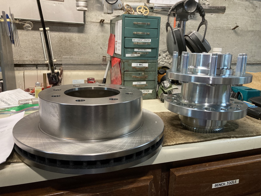

If you use the Spyntek hubs you will still have ABS. They have machined tone ring on the hub as you can see. The other neat thing about the Spyntek hubs are they are dayna 70 parts. If you break down on the side of the road you can change all the wheel bearings and seals for under $100. I have had these hubs on my 98 2500 and now my 99 3500 DRW truck.
