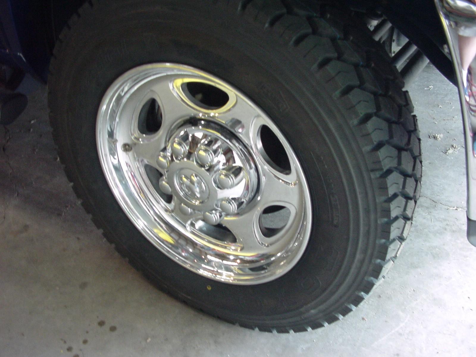

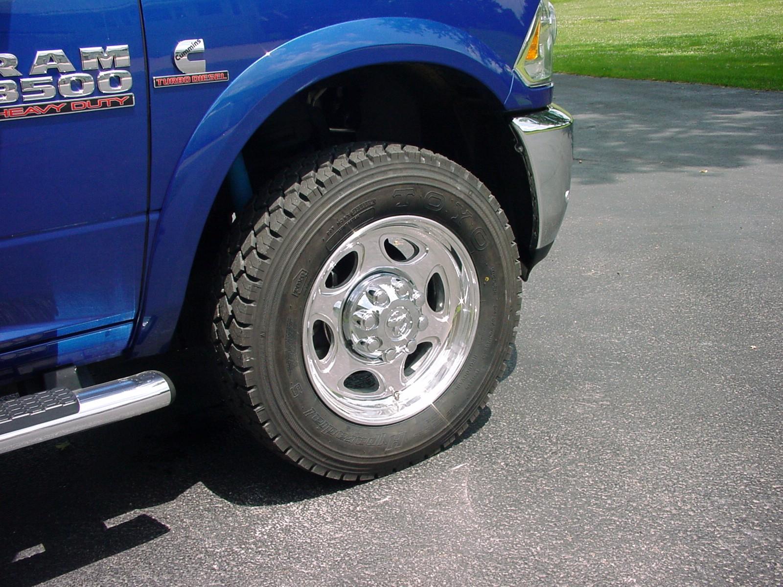

I went with forged aluminum Ricksons polished by me, the best looking IMHO 19.5"s ( not readily available)
I went with Toyo M 608Z 245/70R19.5 136 4900lb cap, and are exactly the dia as my stock 20 inchers .
