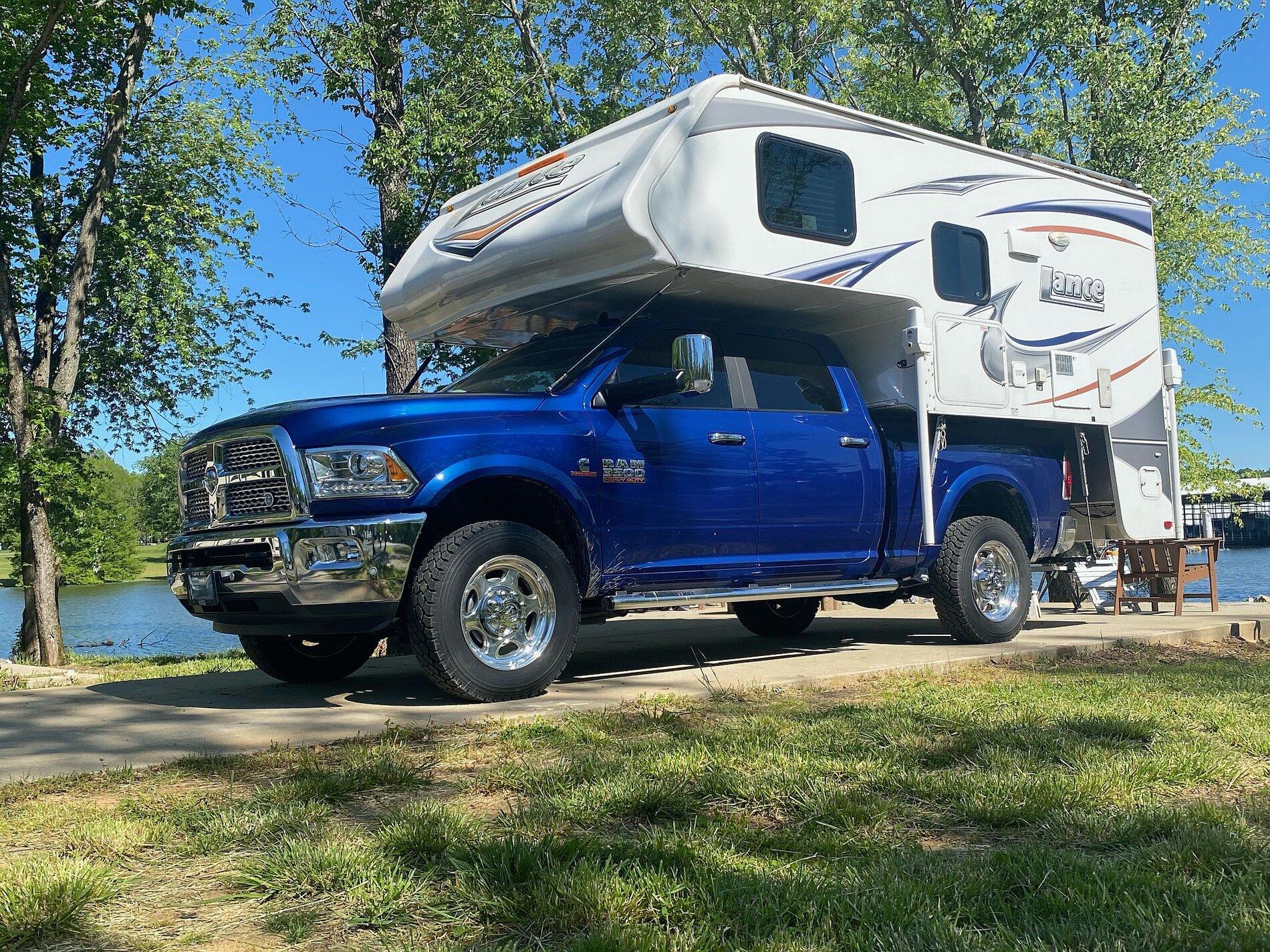

the rig
Those are nice but can you still find them, did they stop making them? You also have the same truck as mine, same year even, different color. I see you have the non slide Lance. Any other suspension mods. How does it ride and do you switch out tires when not carrying the camper or just leave them year round
There are other sites that discuss the offset of 1.5 inches in some cases causing premature wearing of the front end? Is this a real concern and/or are there 19.5 with and offset closer to OEM
I did bilstein shocks, hellwig sway bar, lower stable loads, and hellwig 5300 helper springs (they did not install upper overloads from the factory on 2017 3500 SRW trucks :mad:). Its a pretty good rig and I do tow a 14ft enclosed trailer using a superhitch and 28" extension . I do not think if there is any diff in offset that it is a problem, but you will have hard time finding forged aluminum 19.5" Rickson wheels.
