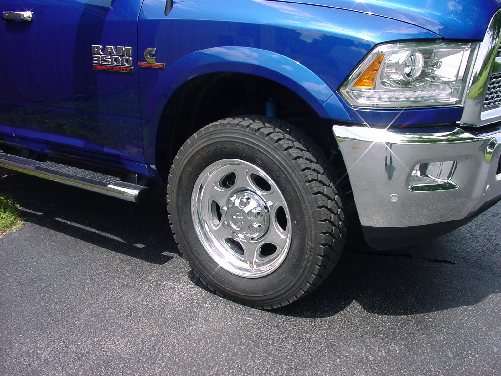

The 19.5" Michelins on my Ram are rated for 4940# each. So close to 10,000# per axle. Since the rear axle weight on my truck is 3220# unloaded, the tires have 6700# available capacity. The Vision 19.5" wheels are rated for 4500# each, so 9000# rear axle wheel capacity. So 5780# available rear axle wheel capacity.

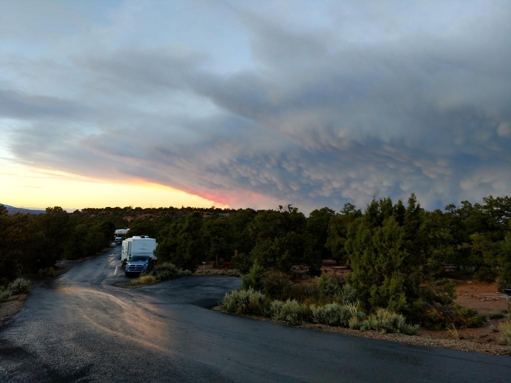

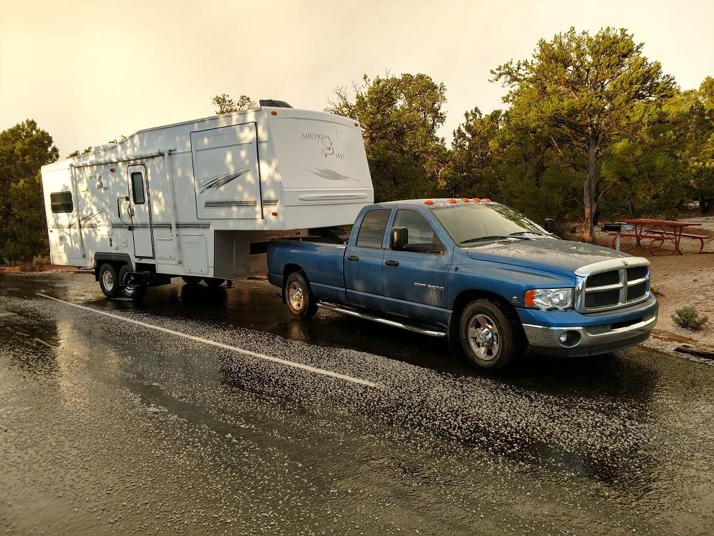

Couple times we enjoyed just being in the RV due to a day or two of rainy weather as part of a week long trip:
Navajo National Monument
North Rim Grand Canyon. Rained on us, but, got some awesome pictures.

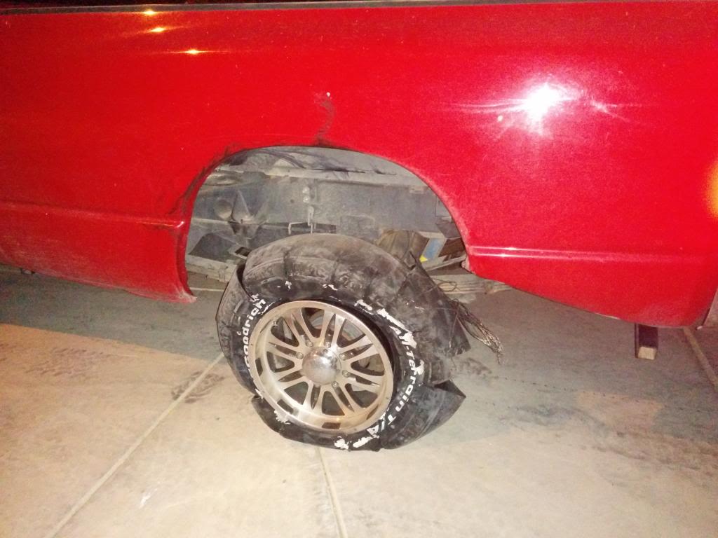

BTW: The reason I push the GAWR so hard is if you run over your tire rating for any length of time things like below happen. On the 06 I had run all the numbers so I was under tire rating then got a new trailer for my jeep. I didn't check the tongue weight with the new trailer so I didn't realize it had pushed me about 500lb over weight on the 4 year old BFG so I destroy two tires and fenders that weekend.

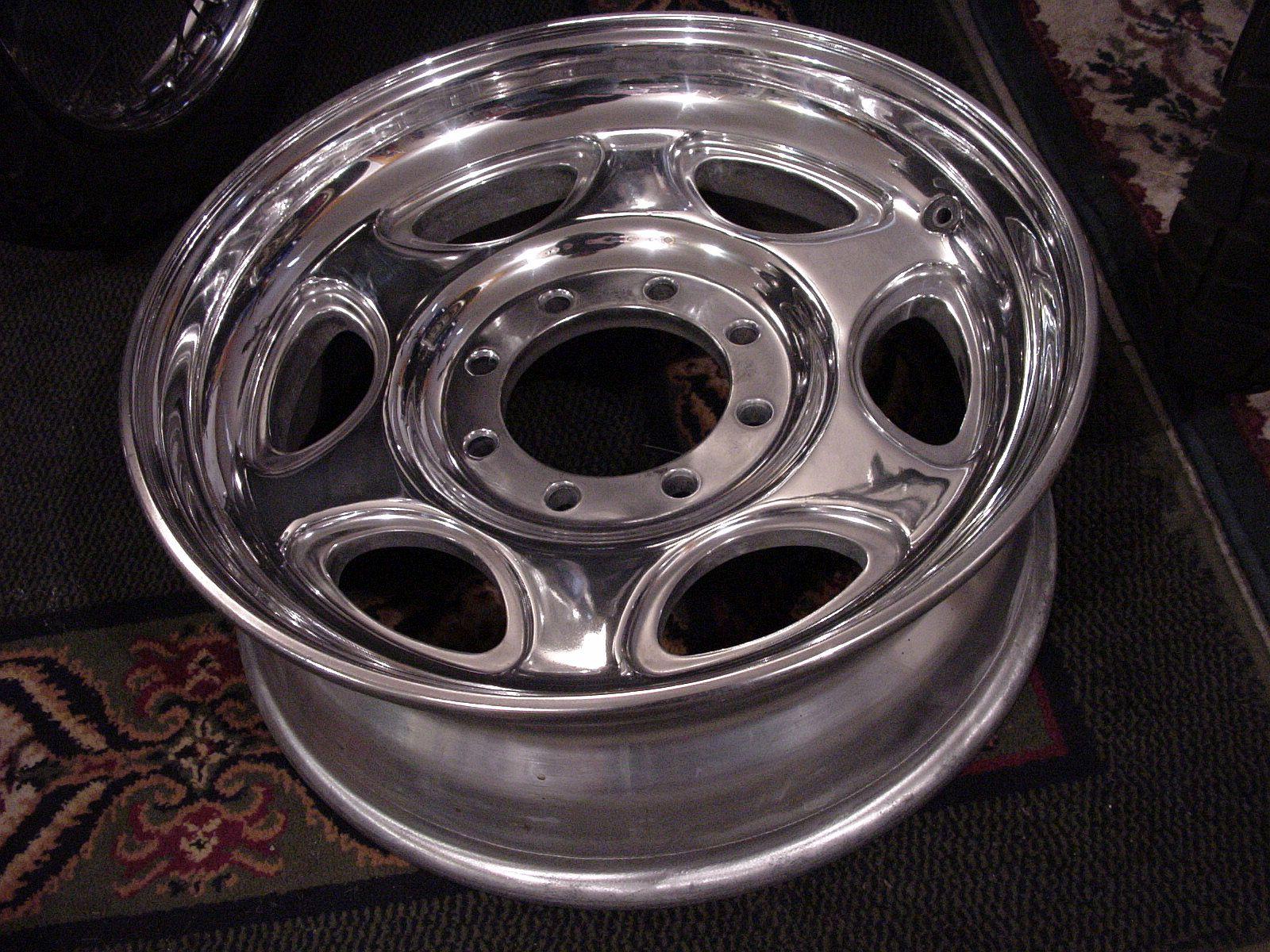

Does anyone know what the actual carrying/weight rating is on the 2017 3500 20 inch rims. Going to pick up AF811sb so will be heavy but nice this next week. My tires are rated just over 4K. I see the rims something like 3500-3700. I will be considering going to 19.5 with 4000 plus tires for stability, better wear I think and slightly better weight capacity but I think a lot of the 19.5 tires are rated about 4000 so the real improvement may be tread compound, durability and the rims having perhaps 500lbs more capacity which I guess is significant
