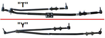

The t-type introduced a dead spot over center and on direction change. As it wore more that became much more pronounced. Coupled with how close the tie rod need to be set to NOT break ends and the strain on the drag link end on the tie rod it was never as tight a feel as the y-type. Once the suspension\tire\wheel setup deviated from stock it all became more pronounced. The t-type components never did wear as well as the y-type, always replacing either the drag link to keep the slack out of the steering.

I agree. As soon as I got the new T type "upgrade" the truck had more bump steer. I have the dead spot at 12 o'clock like you describe. I have the Synergy product now.

Anybody got a pic of T vs Y layout?
