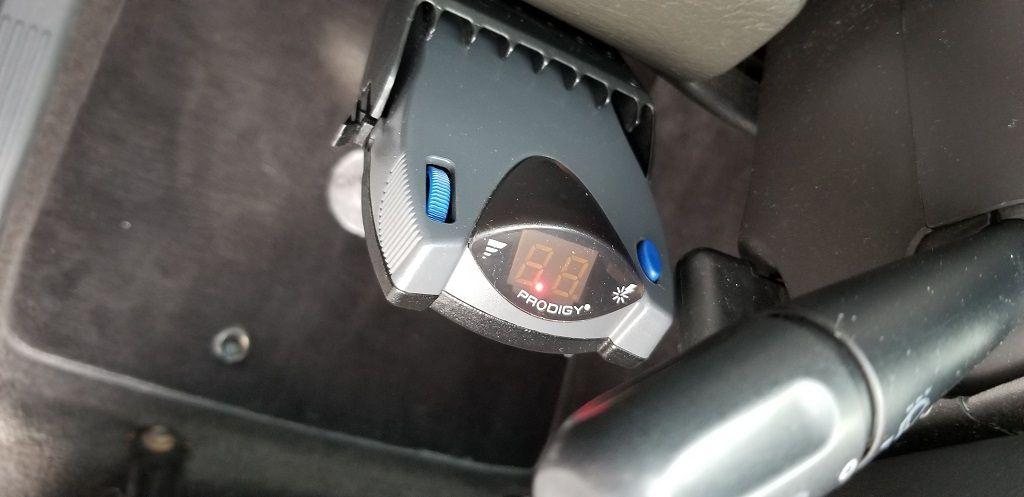

I like my Tekonsha Prodigy P2. I like the fact that I can set the boost on the fly. With my dump I use boost 3 loaded and boost 2 empty, almost never mess with the gain.

I would consider another model from them where they didn't decide "Blue LED's" are just So Cool that they just HAD to switch to them from night vision friendly RED LED's. o_O The P2 Blue LED's are like shining a flashlight in your eyes at night. One Blue LED P2 I had would light the cab up even without line of sight. Only because I paid to install it with a hitch it didn't get returned. Talk about a nasty surprise after install when it lit up blue where past controllers I was used too were red. I used it's quick reference guide to cover the damn blue glare LED display...
Switched to?! Yeah blue from red LED like this "classic" 2003 vintage sporting red LED's.
