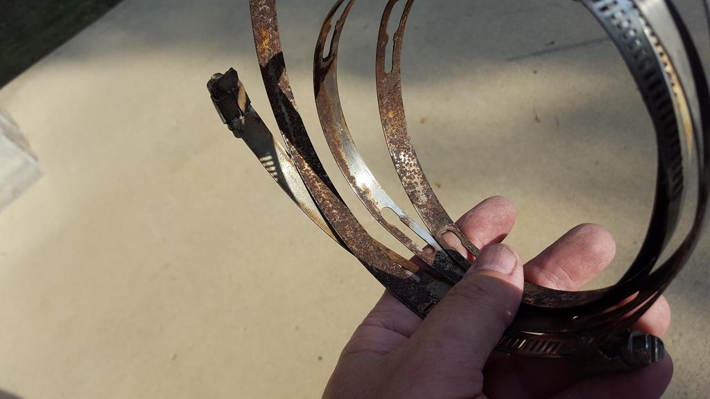

I was getting ready for a trip this weekend and when I opened the hood, the airbox hose clamp was broken. When I looked at it, it was severely corroded where the clam touched the rubber hose. I checked the middle clamp that joins the hose pieces in the center as well as the turbo end.......same thing. All three clamps looked like they had been dipped in acid on the hose contact side. Severe corrosion to the point that they have all but disintegrated. I used a wide AC duct tie to put around the airbox end to make sure it was sealed.
I stopped at the Ram dealer in Jesup, Ga and the parts guy told me I was the fourth owner in the last two weeks with this problem. He had a set of clamps he had ordered for another owner and fortunately, the other guy wasn't picking them up until Monday so he let me have them.
So I'm good to go for now but I don't think this solves the problem. It looks like there is a chemical reaction between the rubber hose and the clamps causing them to corrode. The clamp didn't break because it had been over tightened. It corroded in two.
So now, I have to figure out a solution. A new hose is $300 through the dealer or $200 through Mopar online. This is BS. If the Jesup dealer has seen four in two weeks as small as that town is, then this is going to be an issue for a lot of other owners.
If if you decide to check yours, you can just look at the clamp edges for heavy rust. To really check, you have to release the clamp completely and look at the underside of it.

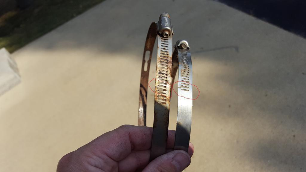

I just replaced all 4 clamps, the one closest to the turbo had broken in half , 2 others have started to break (half broken) and the last one is just very rusted at 45,000 miles. The clamps on my sump pumps don't get this bad! I ordered 2 of the clamps from the dealer 53034043-AB (list price is $22.99 I paid $14.70) other clamp is 53034045-AB (lists is 5.99 I paid 3.20), The middle two clamps must be part of the silencer assy and do not seem to be available separately. So I bought plain Ideal worm gear clamps from my local Ace Hardware, and just cut the little rubber nipples off of the hose (used by the OEM clamps to keep them properly oriented). Sizes are 4 1/2 ", 2 5 1/2" and a 7".

Good pics. That's what mine looked like as well. I have posted this on the 4th Generation forum as well since mine is a 2015. I can't imagine what is eating up these clamps.
Thank you Alan for the heads up on checking the clamps, mine is a 2013. I would bet money that this turns into a recall, just crappy clamps. Factory clamps are Ideal-Tridon -0- (no other markings), clamps from Ace Hardware are also Ideal-Tridon with additional stamp 300SS.

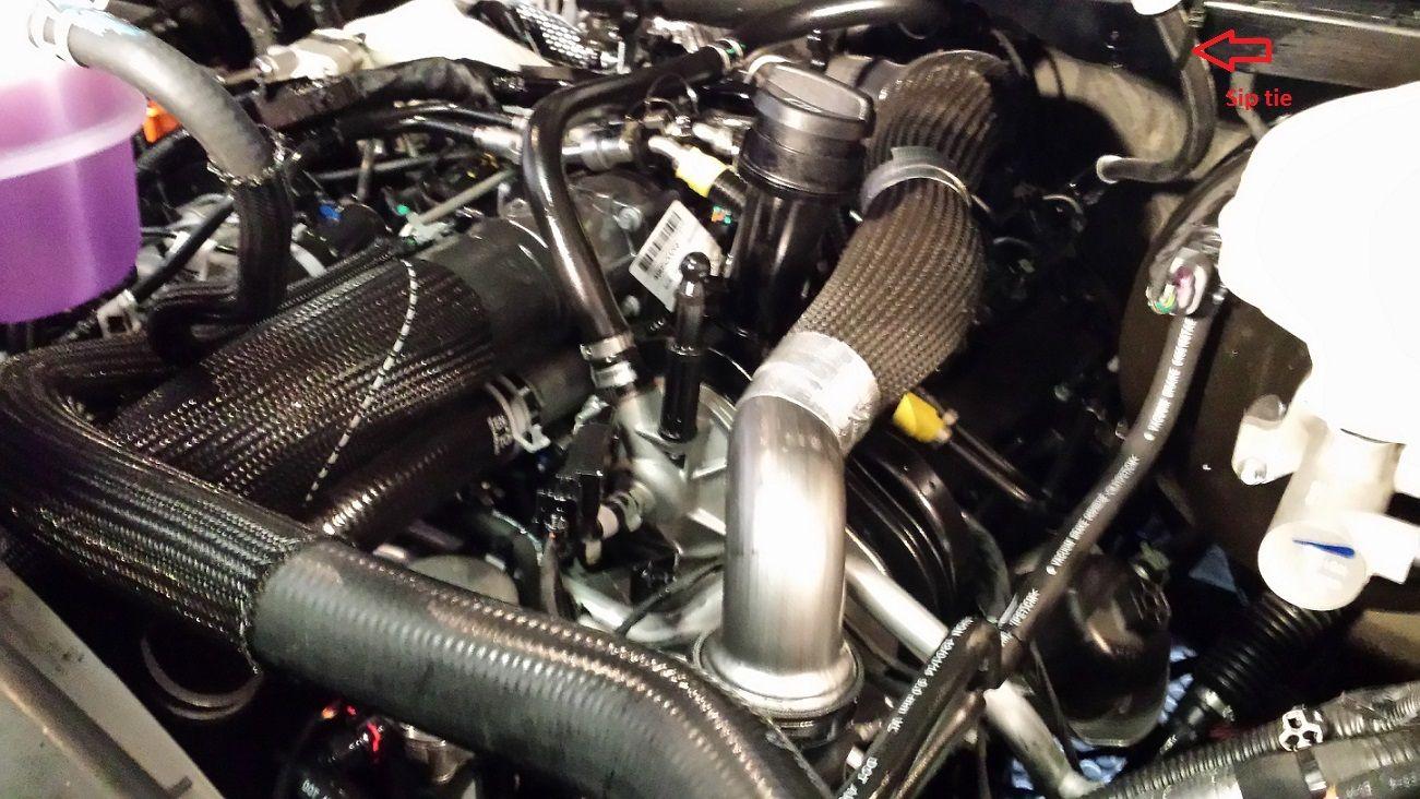

Chloride...................Thats why in additions to the Dia-electric I clear coat everything... this is what all My engines look like when done
