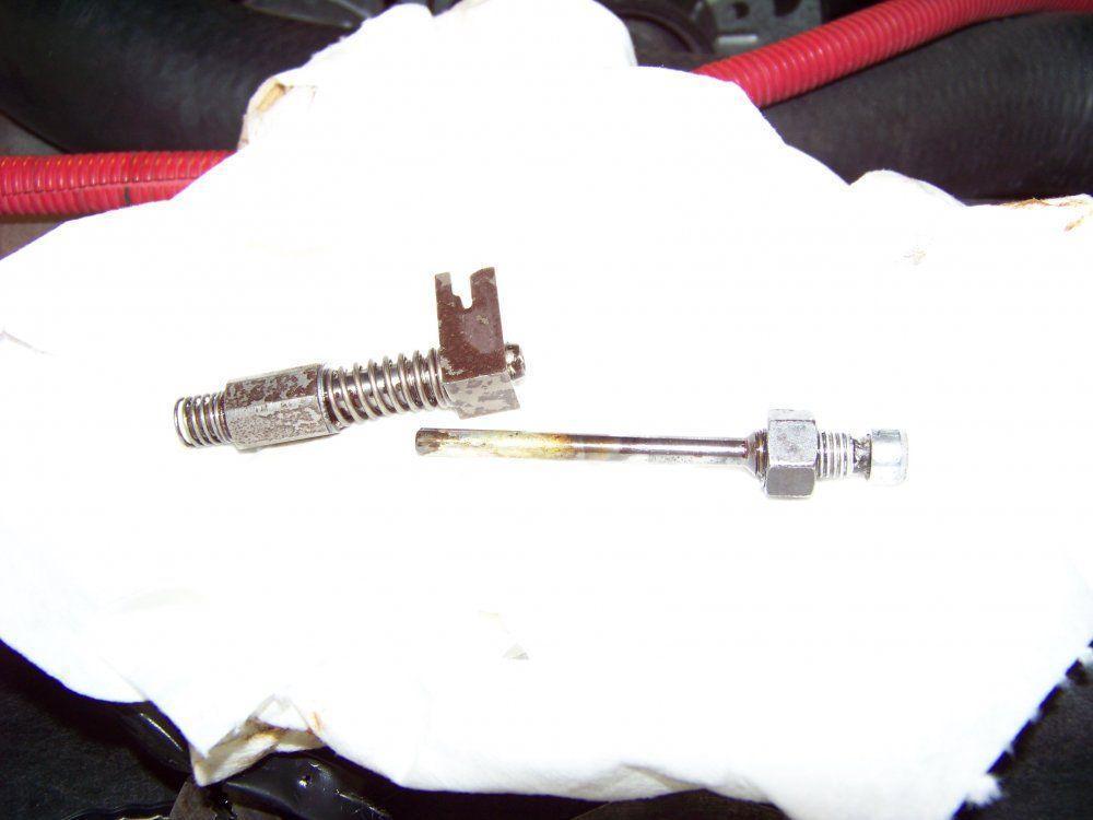

Biodiesel has cost me plenty in downtime and repairs so I am perfectly willing to serve as a bad example. Again the injection system that survived the bad fuel had a CAT water separator installed. The OEM fuel filters can't handle biodiesel and will allow enough water by to ruin even an old IDI injection system that eats dirt for breakfast vs. the low tolerance HPCR systems. After running thousands of gallons of B99 without much trouble the bad fuel makes me suggest you are taking a gamble on any bio% without an additional water separator. Without much trouble means change the oil more often, find a methanol compatible fuel pump (for the leftovers of it from the biodiesel process), and have spare fuel filters in the truck.
This is what the insides of a failed, corroded, DB2 IDI injection pump looked like after B99 use without an additional water separator. The pump would no longer start with the engine hot due to head and rotor problems that you can see why... part of the governor shaft shown
This is what the insides of a failed, corroded, DB2 IDI injection pump looked like after B99 use without an additional water separator. The pump would no longer start with the engine hot due to head and rotor problems that you can see why... part of the governor shaft shown View attachment 98617
