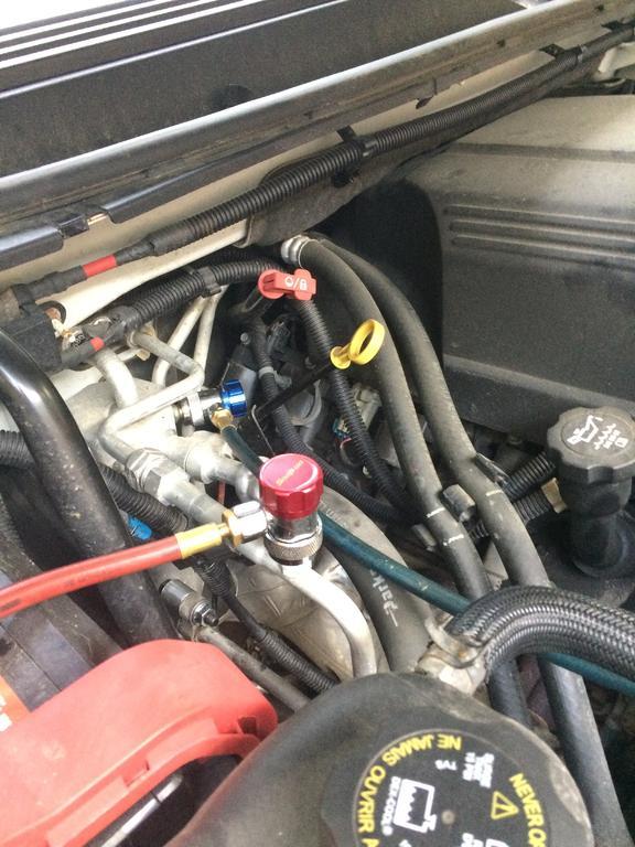

Well I apparently didn't get an overview shot of the underhood plumbing.
What the deal is that the rear A/C lines are connected to spurs off of the front lines under the hood. You could change the underhood lines over to a pick up set up for example but I think the block solution is cheaper UNLESS you have something wrong with one of the front lines, then a changeover might make sense....

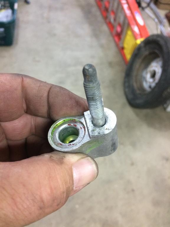

Each spur has the standard one bolt flange and sealing washer combo that most GM's use.
I did some hard core surfing and finally settled on these as a durable solution....

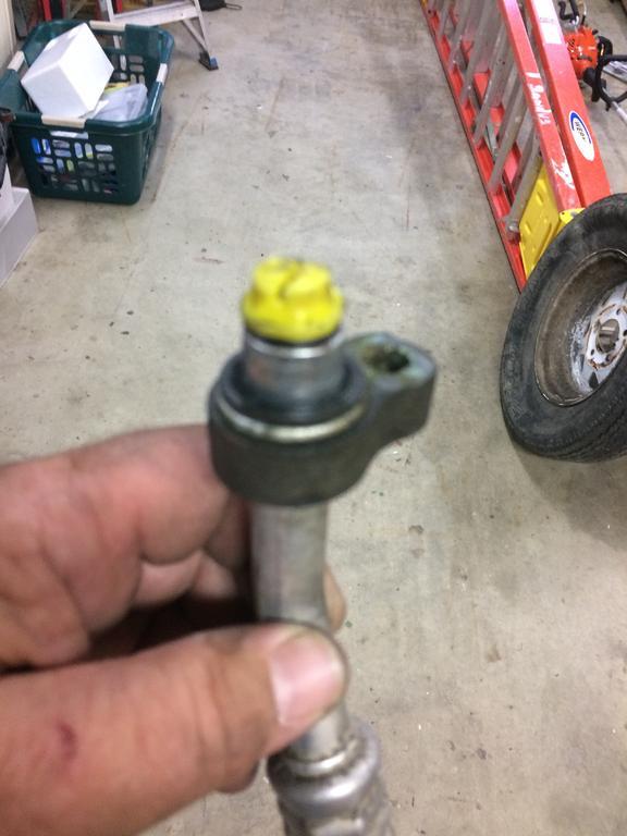

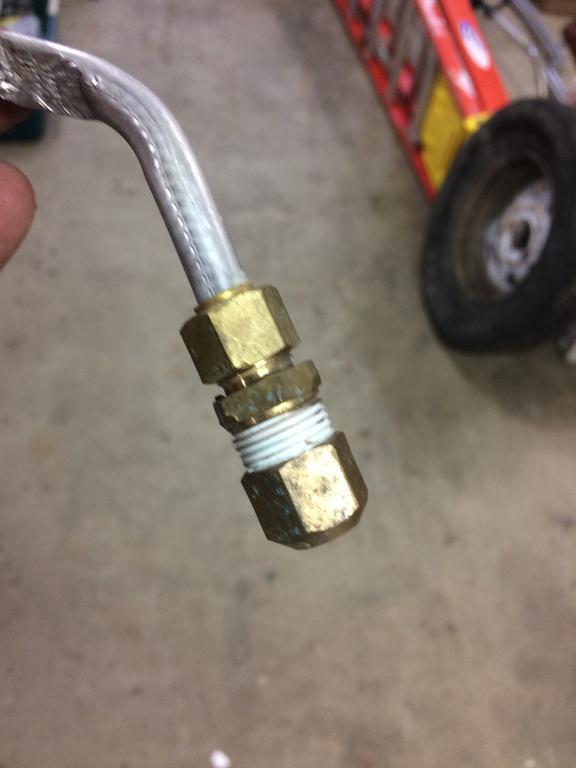

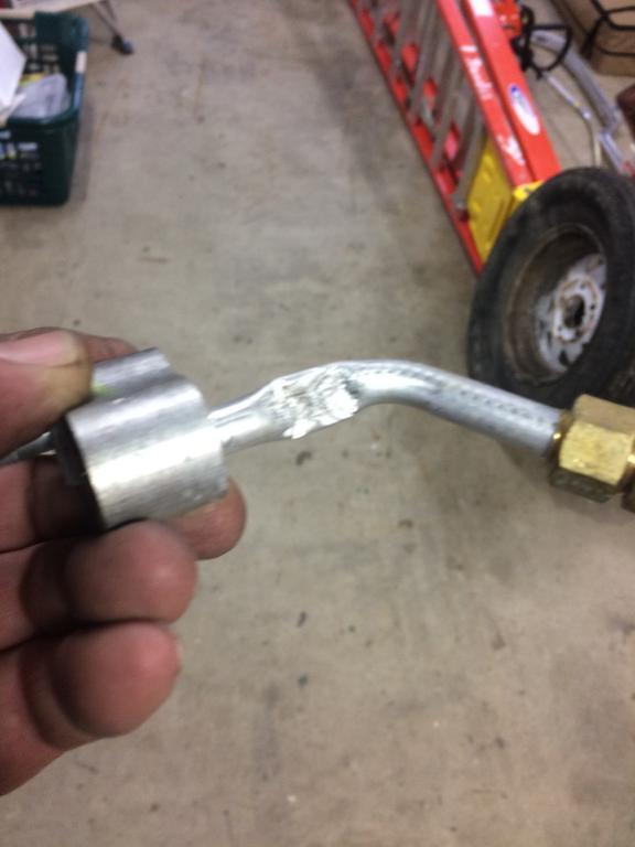

Now for what I removed...
High pressure line capped..
Notice the extra effort expended in trying to squeeze the line closed...
Then this gob of brass was the final seal...
And as you can see it didn't work as the dye and oil left some residue on the way out through..

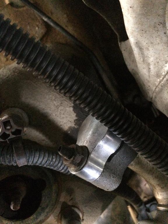

The low pressure or suction side was even more crafty...they simply disconnected the fitting and stuffed a plastic plug in there along with a rubber cap from something (which I destroyed while trying to get it out of there) and then bolted it back together...
Plastic plug...
So once I got that mess cleaned up and the suction line cut off back by the accumulator I installed the block off kit....
Low pressure block off
High pressure block off

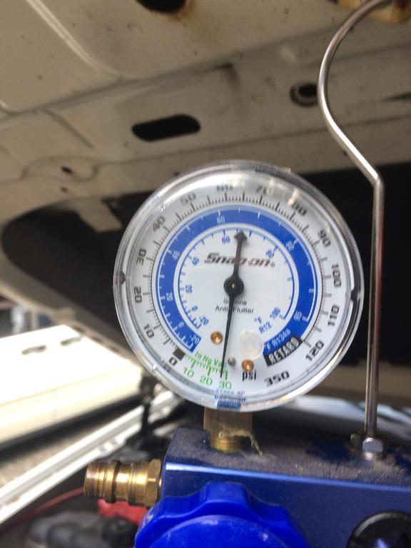

Put it under vacuum and had a small leak. Re-tightened the low pressure plug and leak stopped. I suspect that the spur opening was a little distorted form the plastic plug and rubber thing being forced in there....
2nd Vacuum down...
All good now!!! We'll see if it holds more than two days.....

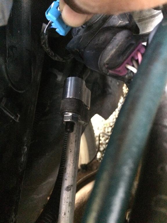

I'll try to get an overhead shot tonight but the locations are as follows..
High pressure spur = right in front of the accumulator
Low pressure spur = right beside the front of the rh exhaust manifold.

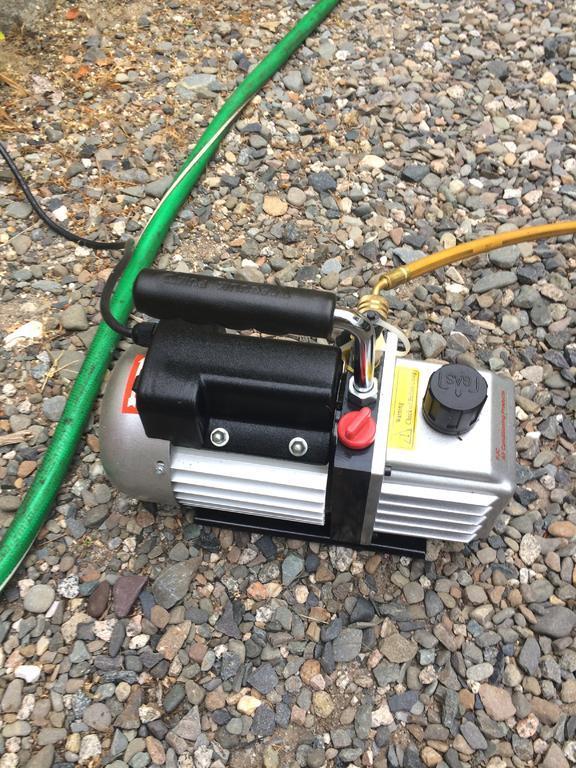

Mike is that your vac pump in the picture above?
Yes, I bought it several years ago. I wish I had purchased a bigger one as this one struggles to hit 30. That's where you need to be to boil the moisture out of a system that has been open....IF you leave it long enough it will pull 29 1/2 but I was rushing last night and the system was not completely empty when I started the repair so it got a quickie......
