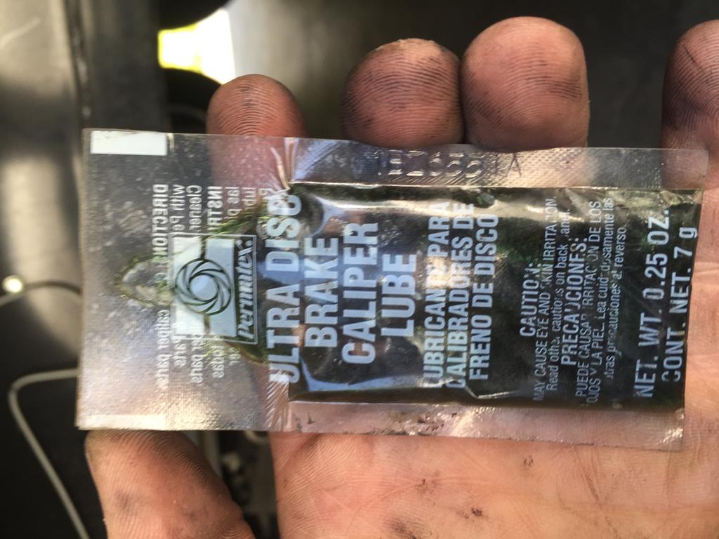

Did you use the proper silicone grease to lube all mating parts/sleves and where the back of the pads make contact with the calipers?

As for your squeeling pads I found that the rear pads were stuck in the slide on my 2013. Stuck with rust. I had to remove the pads and clean the rust out. The tabs on the pads were slightly bent from the calaper forcing them in when stopping the fact the tab was stuck and got bent would not allow the pad to move off the rotor when the breaks wee released. At 54,000 miles all the pads have better than 2/3 of their life left.

I just had brake issues with my 2012. I also has some squealing but didn't think too much of it. Saturday I was rotating the tires and noticed the front right lug nuts were too hot to hold even though I had only driven a few miles to the store a half hour earlier. I found the inside brake pad was worn way down and the wheel would not rotate by hand no matter how hard I tried. It seems the pad had become stuck/rusted in place. I replaced the pads on both sides and lubed the slide points with caliper grease. Now the tire rotates easily and and a 60 mile trip Sunday even showed my mpg was up too.
