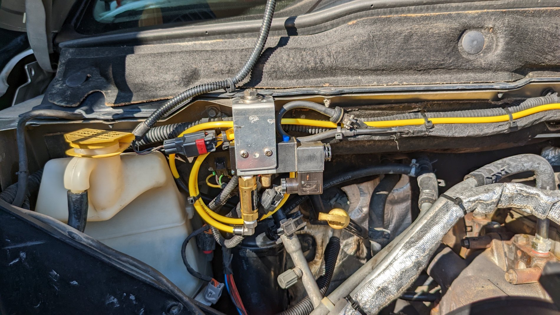

This is a follow up on the test drive and several days of operation. For sure, the original problem of the "slow release of the exhaust brake" is gone, but a different issue popped up - the compressor immediately cycles "on" the instant the exhaust brake is applied - every time. The compressor runs for about 3 seconds and then cycles "off".
Previous to changing out the directional valve and adding the 100 psi pressure reducing valve, the compressor would cycle "on" with the third application of the exhaust brake, which I considered to be normal. I determined that the cause of the instant cycling was from the combination of the condensed mounting design of the compressor, pressure switch, and directional control valve all right next to each other, plus a "faster opening" new valve.
I left the components in the same location, but I removed the "T" fitting that joined the compressor outlet / pressure switch to the directional valve. Basically, I plumbed the compressor / pressure switch straight to the air tank and then plumbed a second line from the air tank back to the directional valve. This corrected the instant cycling.
While I was doing the project, I decided to get rid of the compressor mounts - three rubber mounts with steel sleeves and through bolts and nuts. The design did nothing for stopping compressor vibration from being transferred to surrounding components. I purchased true vibration isolation mounts and installed them - what an improvement.
