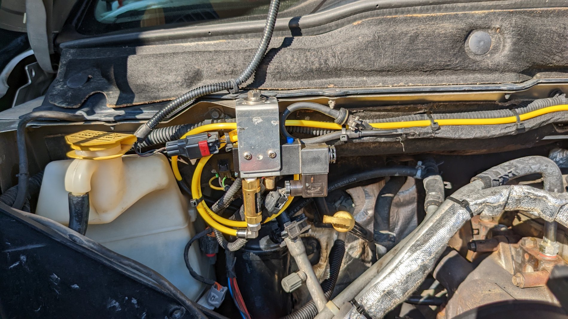

I grabbed a flashlight and began to look for issues. I checked all the boost lines and they appeared intact. Inspecting my Pacbrake PRXB, I noticed the air operated piston was extended which indicates the exhaust brake was activated (should only activate when off throttle in forward gears). My assumption is the electric solenoid failed, not releasing the air holding the piston extended. This left the butterfly valve in the exhaust closed, blocking off all but a small portion of the exhaust coming out of the engine. It was kinda hot after that run.
I released the air line at the solenoid which let the piston retract, opening the butterfly valve blocking the exhaust.
On the road again, sans Pacbrake, driving the mountain roads towards Oakhurst. After a couple miles of mountain roads, I heard a pop. Pulled over and checked the trailer tires. After I looked at one side, the obvious occurred to me and was confirmed by a look under the hood. My trusty Pelican flashlight that has been with me for 15 plus years died a glorious death. I had left it on top of the valve cover earlier to work on releasing the air line. After the short drive, it fell off, onto the hot exhaust manifold. Both lithium cells exploded, rendering my favorite light deceased. Forturnately, the engine compartment is mostly metal and survived just fine.
Today, I tested the solenoid and it (and piston) seemed to operate just fine. I replaced it anyway with a new solenoid and kept the old one in the truck for a spare. Maybe a glitchy solenoid, on it's way out? Maybe the piston jammed? I did notice the piston was installed with the air line facing down, making it impossible to lube with oil. I removed one side and spun the piston 180 degrees (air intake facing up) and lubed the orifice. Seems to work fine. Not even sure how long I have had the PRXB, maybe 15-20 years? Love it.
I had a similar occurrence not too long ago.
The pressure switch on my HP625 air compressor failed in the closed position one morning on my truck. The compressor came on and would not shut off. I don't know what the ultimate pressure built up to, but it did not trip the 200 psi safety relief valve. Anyway, with that excessive pressure my PacBrake became fully engaged. I'm guessing the pressure overpowered the air solenoid that controls air to the air piston. Luckily this happened just as I left my driveway so I was able to turn around and pull into my workshop.
Anyway, when I got back to the workshop I also discovered that the unloader valve had also failed due to water and corrosion, so I replaced the PacBrake unloader kit (which includes the pressure switch) with my own bespoke setup and haven't had any issues since. I did not ever replace the solenoid, it still works just fine.
Might not be your problem, but I suggest you check the pressure switch functionality and measure the total pressure in the tank. The air piston solenoid works fine up to 150 PSI, which is what I run, but at some point excess pressure will bypass the solenoid and engage the brake. Pressure switches are only a couple bucks.
In run a 100psi pressure reducer right at the solenoid for this reason.
That pressure is still plenty for the piston to close the valve and safe for the whole System.
The solenoid itself is from Amazon too.
Will look into those suggestions, thank you. Probably criminal if I don't send pics.
Solenoid is this one..
