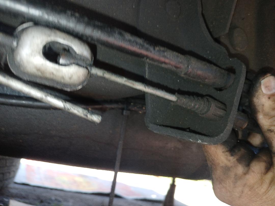

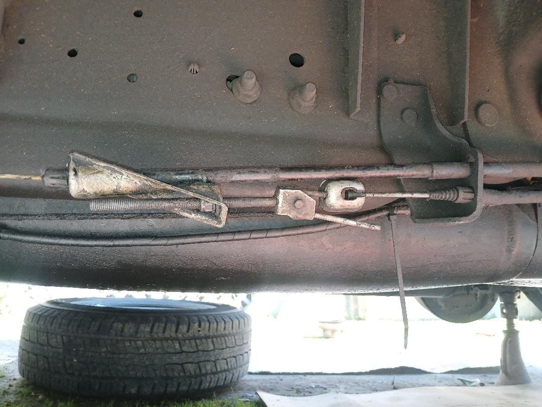

I took a picture of the cable adjust arrangement. In the top picture, you can see that I've taken up all of the slack that I'm able to with the set up. Is this the correct brake cable? It has one cable going from the emergency brake pedal to where the adjustment arrangement is, then it splits into 2 cables, each going to their respective drums. The top picture shows where the cable is bent around the hardware to "fasten" it. It's the bottom cable in the top picture. Surely this is not the stock arrangement?
The lower picture shows where there is no "sleeve" around the top cable where it goes through the hole in the bracket at right. It is more visible than it is in the top picture.

That's what my park brake assy looks like. Have you opened the manual and followed it's procedure? Are you sure the cables to each side are moving inside their housings? I had one freeze so the park brake didn't work much at all. Once the cables are adjusted the procedure is to adjusts the brakes manually. You shouldn't have to touch the cable adjustment. The auto adjusters just don't work very well. I do mine every other oil change. Adjusting the rear brake shoes might also give you your pedal back.

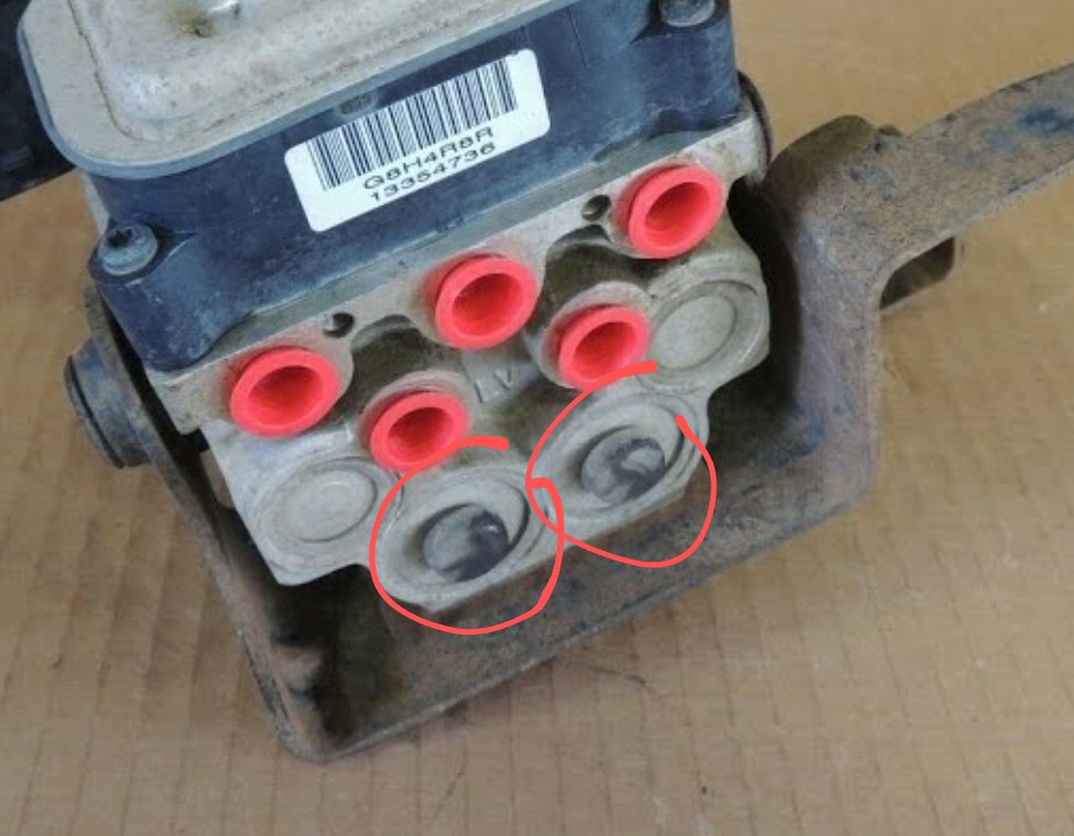

The dump valve can fairly easy be checked from the outside.
Check YouTube for how to do that on the Kelsey-Haynes ABS unit.

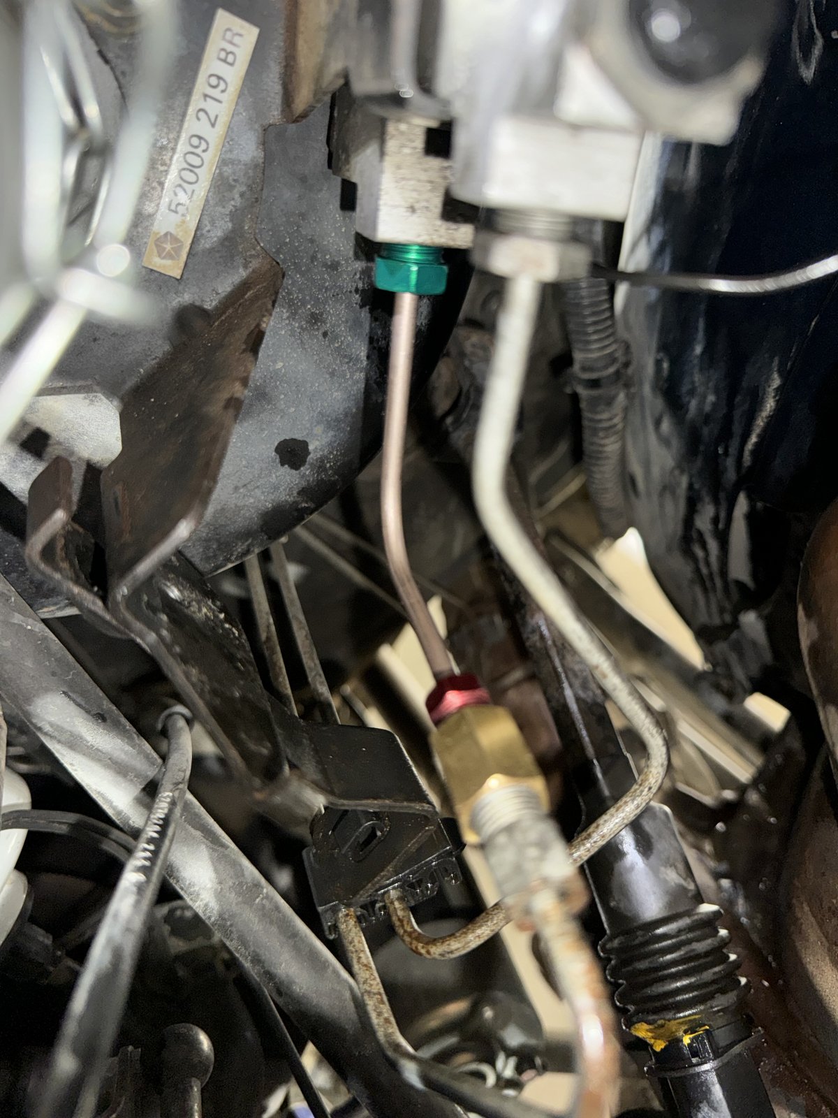

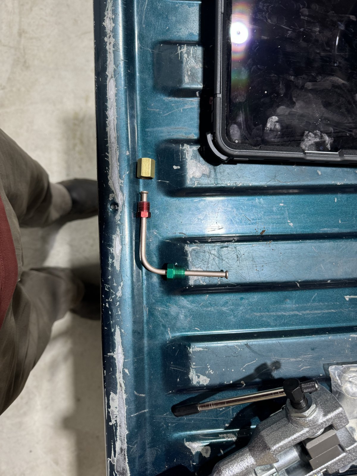

Ozy I was never able to find a way to check my dump valve but I did spend a little time yesterday made this brake line up to bypass my abs block. However it did not fix my problem.
You should have these two rubber grommets.
Take them off, put a needle or something into the hole(s) and have someone push the brake pedal - if the needle moves outward your unit is leaking. If it does not move your good.
