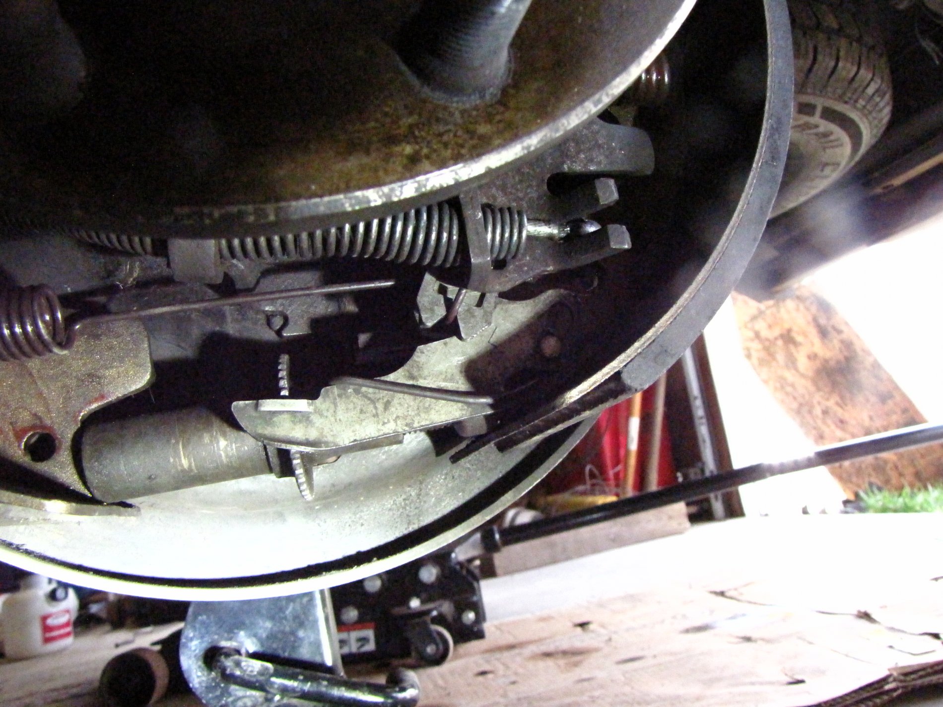

View attachment 143060 I have been trying to figure out if I have this adjustment lever in the right spot as it does not make contact with the adjustment wheel no matter what I try. Not sure if it is supposed to be this way or not but I thought it was always supposed to make contact with the star wheel on the shoe adjuster. I have looked at several diagrams to make sure I have all the parts in the right spot. I had found the cable spring going to the adjustment lever hanging loose when I pulled the drum as the shoes backed themselves out and were not making contact with the drum giving me a LOW pedal in the truck.

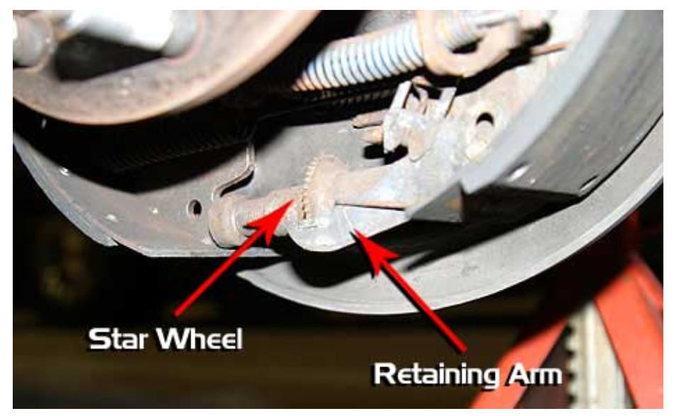

The photo below shows the correct adjuster position when service brakes and parking brake are released.

Yes I did adjust the park brake actuator months ago. The shoes are resting on the anchor pin up top but I will back off the actuator anyway and see if that helps.
Could it be on the wrong side? What’s the other side look like?
Looks like the picture John posted above plenty of space on the side to the left, but the diagrams showing what the picture shows on the right hand side of the picture

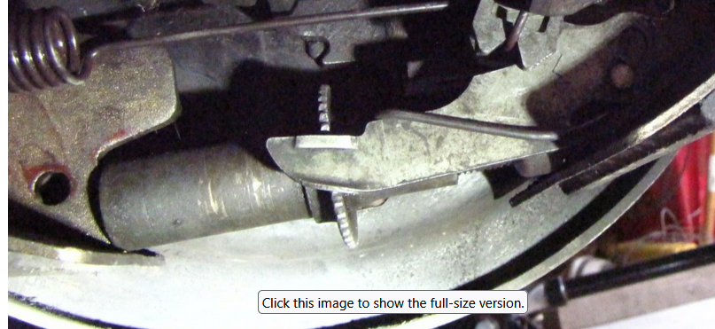

I think that you have more than one problem. After looking at your first photo again - the adjuster wheel is installed incorrectly. The threaded part of the adjuster should be on the left side of the lever so the toothed contact area doesn't change. Also, usually that type of tooth pattern is not symmetrical, the teeth are angled to favor engagement. You need to verify this and verify that the adjusting wheel is rotating in the correct direction after reversing the adjuster's position.
My guess is that you have the same problem on the other side.

The photo below (your photo) is incorrect.

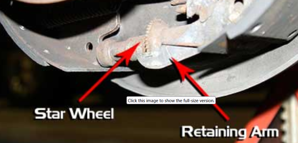

The photo below is correct.
- John
Thanks, guess I will have to pull the drum again and turn around the adjuster wheel
