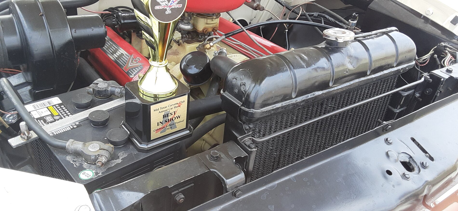

Just posting to brag. The third time on the street was a trip across town to a show put on by the local Corvette club. Only about a dozen vintage cars, quite a few Hellcats and Chargers, a couple Mustangs and of course Corvettes (disappointed no '64 split windows). Won best of show AND they drew my number for the 50/50 raffle. Winner, winner, chicken dinner.
