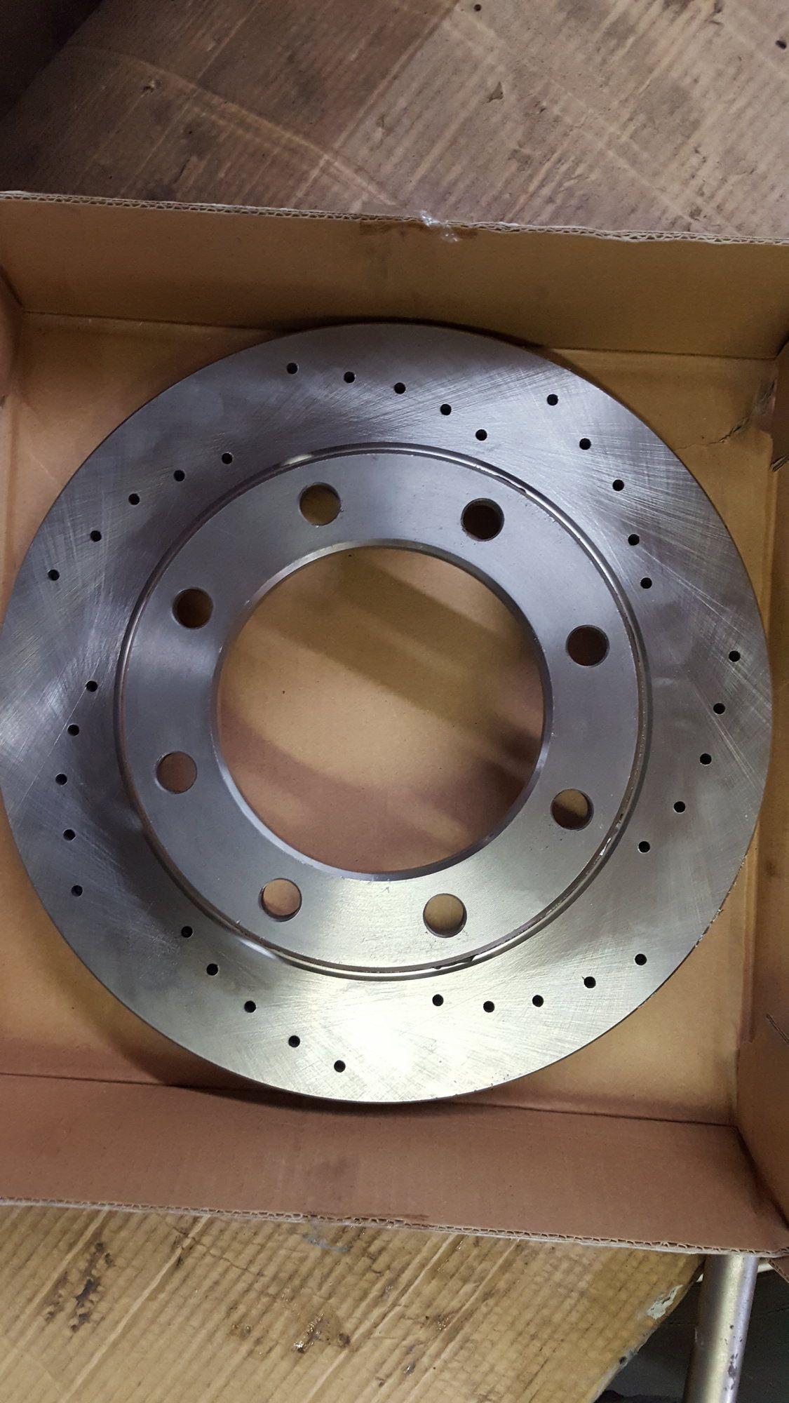

back story, a several years ago i a set of power slotted rotors from EGR breaks I was a little disappointed when they showed up in weaver break boxes with the same part number as the store brand ones, but i put them on and they did work really well till the slots wore off. flash to last year and i needed new rotors, after looking at the price and wait times for slotted or cross drilled rotors i decided to try some thing. I went to the parts store and got a set of weaver rotors ( same as the EGR ones just minus the slots) for $45 each, brought them home put them on my drill press and carefully cross drilled them to get this.

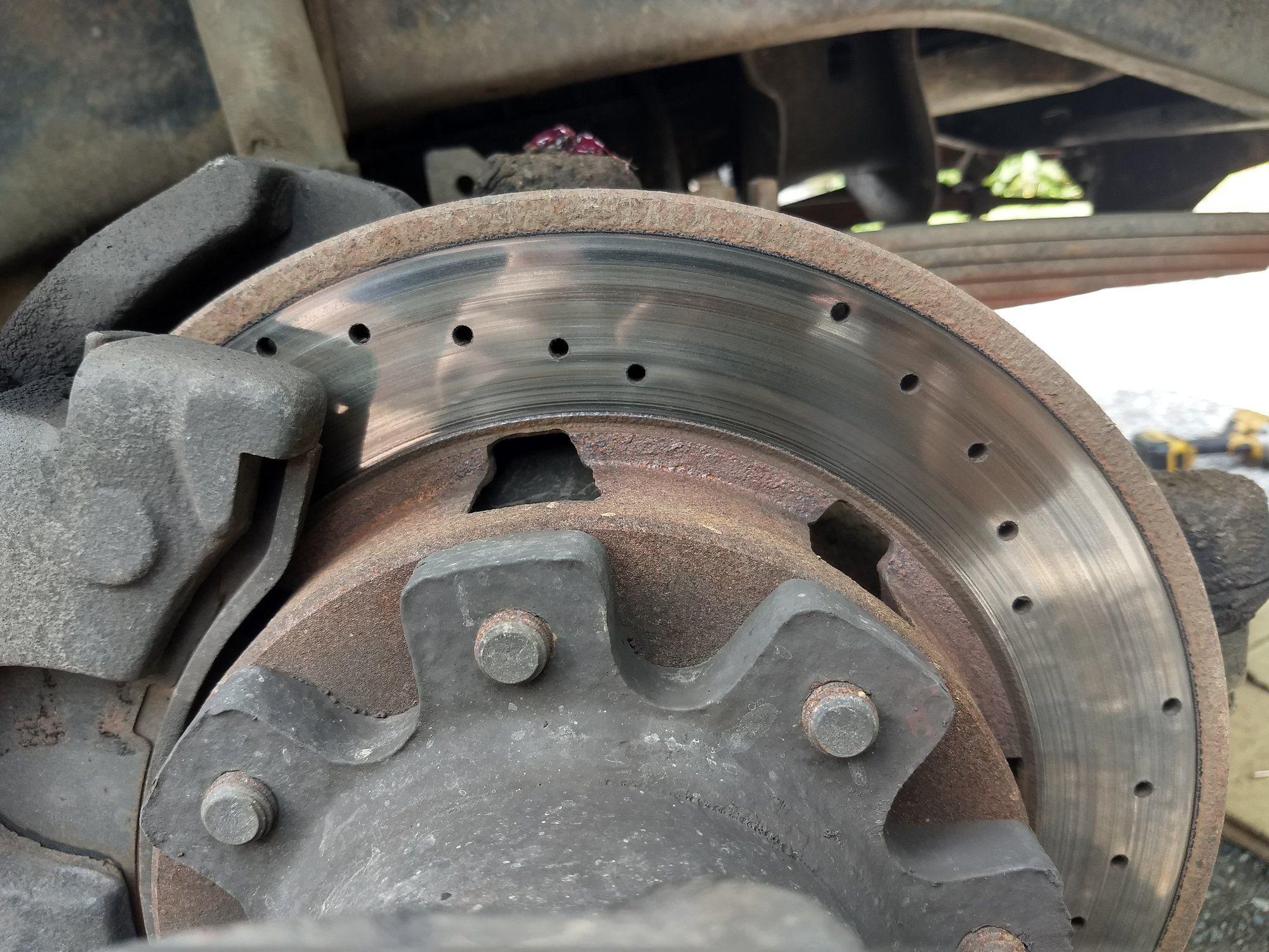

Today i pulled the wheels to rotate the tires and have a look, with 20,000 miles on them they are wearing well, no warping, cracking, or any thing else out of place
