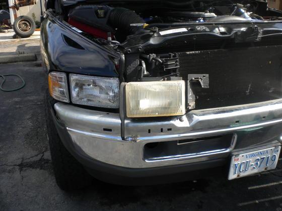

Geno's has headlights for my 97 for $85. 00 each. Geno's is pretty meticulous about checking their products so I got two and put them in, BOY am I impressed! I did not know how bad they were until I did a side by side comparison. The whole thing takes about an hour, even with my arthritis! I also chose to cover them with headlight film from LMC truck, I'm hoping that will keep them from becoming dingy for years to come.
Just saying, glad I went with new headlights, and glad they were readily available.
George

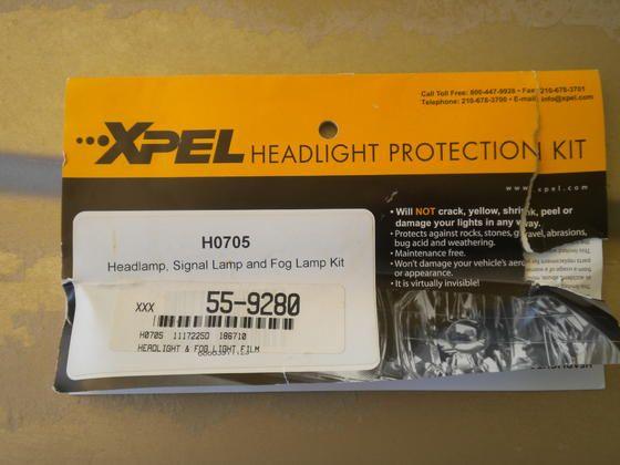

I'll definitely give a report on the film, it is NOT cheap. I figure my truck is now 16 years old and the headlights may not be available all that much longer, so I was trying to make sure they live as long as possible!! In case anyone is interested, I'll post a picture of the film used.
George

Wher did you get this stuff as I am very interested?
I got that from LMC truck, it is www.lmctruck.com if you want to go there, their part number is on the bag in the picture if you want to look it up that way.
I think you can buy it directly from XPEL and their web address is as simple www.xpel.com.
I'm hoping it works as advertised, but the jury is still out on that.
