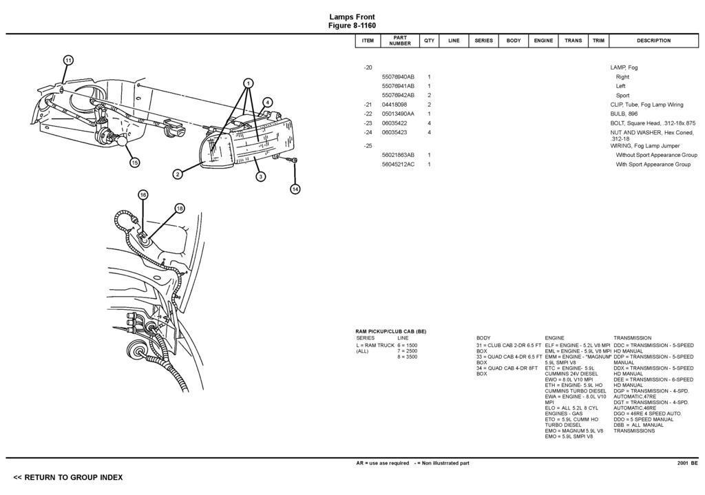

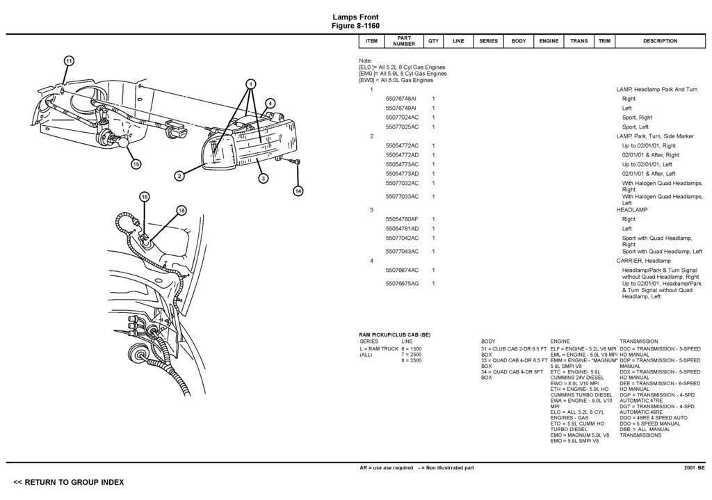

Hi Bob, using Sport OEM parts, do I need the: - lens and housing ( 55077043AF & 55077042AF) , or
-headlight assembly (55077025AG & 55077024AG) ?
It is not clear to me and I do not want to end up missing parts. I see there is a separate part called Mount Panel which is included in the assembly but not in lens and housing. Do I need that or I can reuse the one from my existing non-sport lights?

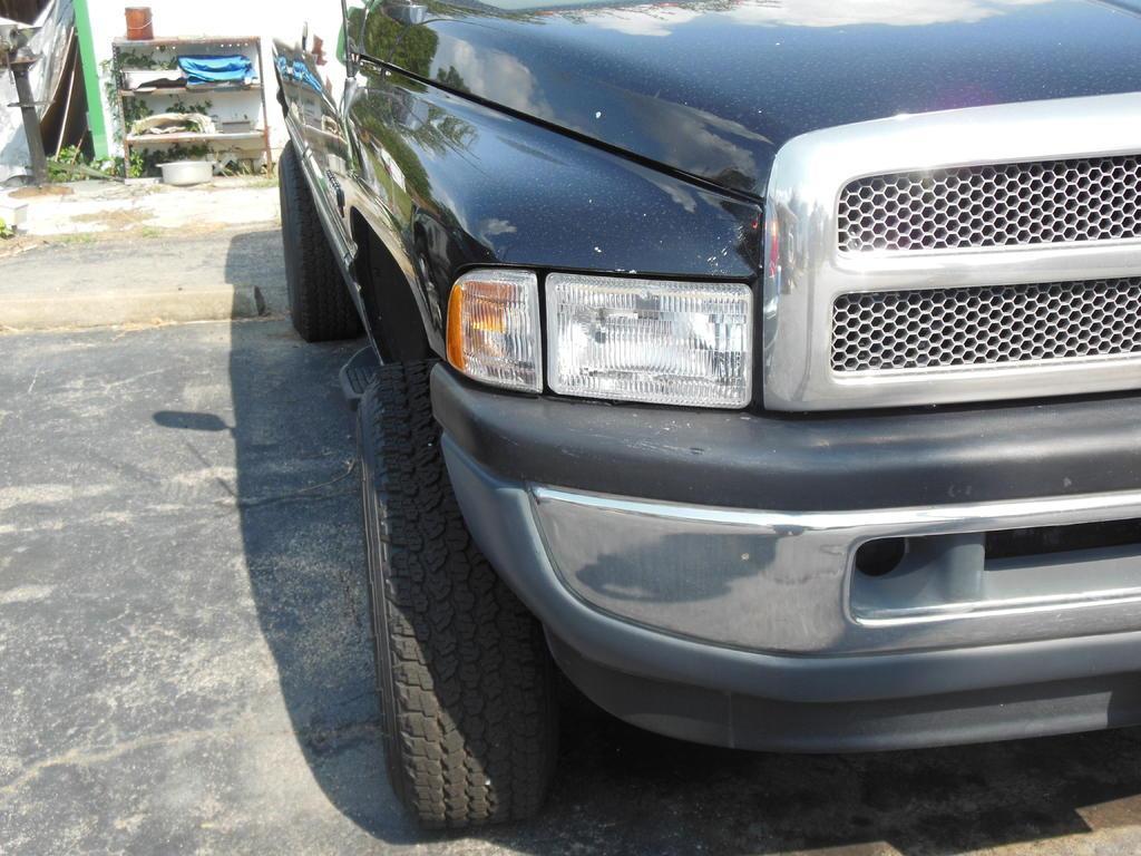

Thought I would send along an update. It has been nearly three years since I put in the new headlights and covered them with the plastic from Xpel.
Here is a picture I took Saturday (yes, I know the truck is dirty). I can't tell any difference, so I'd have to say it seems to me like a success!
I'm happy with it.

Anyone have an OEM part number for the headlights? I'd like to snoop around and see what I can get Mopar headlights for vs aftermarket. And, where to get the harnesses to run them? Every link I find no longer exists....And lastly, can anyone show me pics of a truck that needs trimming and one that don't ? .....
