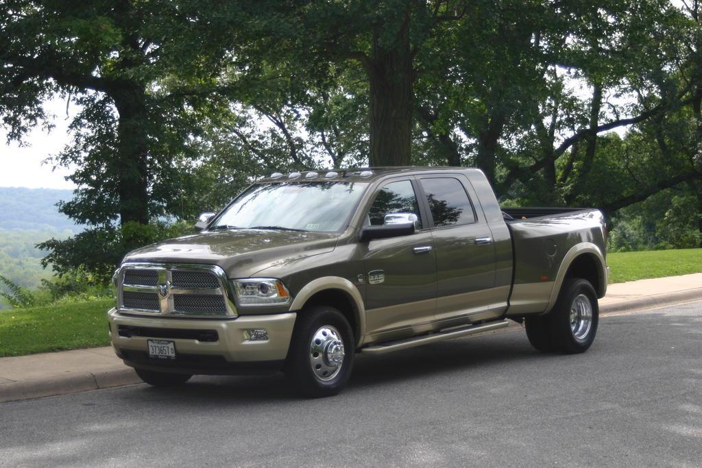

Glad you got that fixed soundz like you have same truck I have I just love this new truck. We just took It to Fort Bragg and back, It pulled our 39ft 5th wheel like a dream I have always liked the Michelin tires. I've not had any trouble with the Nexen tires Knock on wood. But when I do replace tires it will most likely be with Michelins. Maybe its just the various runs of the tires, and we just got the good batch lucky us! What color is your new truck.View attachment 90014

You have a nice truck, looks just like mine except mine is white.
