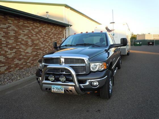

I posted a couple of days ago about a cooling problem I am having. After a lot of research, I think I boiled the problem down to this: If I had a thermostat problem, I would overheat at idle. But since my idle temp is good (190) and my problem is when under a load, it makes me believe I have an airflow problem. I have checked my radiator, charge air cooler (intercooler), and condensor as well as the transmission cooler and P/S cooler. All are clear and free of debris. Which brings me to an interesting question. In April I installed an Aries 4" Bull Bar on the truck. The main hoop goes across the main horizontal cross beam of the grille but the uprights cut across the grille. The cross bar of the bull bar is up high enough to make it just a little inconvenient to open the hood but I can angle my wrist upside down over the top of it and unlatch the hood. I also added 2 PIAA fog lights that are mounted on the bull bar's cross bar meaning to open the hood, I put my arm between the lights. Is it possible that this Bull Bar is restricting that much airflow to cause the truck to run 215 to 220 under load at highway speeds? Does anyone else have this Bull Bar?
Can you post a photo? Are the fog lamps in front of the grille?

Ryan: The fog lamps are in front of the the body just below the grille. They are 6" across. I tested the new stat and it opened all the way in near boiling water and closed as would be expected sitting on the counter. I have a heck of a time trying to post pictures here. I will try though.
Not to be argumentative, but I have a hard time believing this bull bar is causing this. I can't be the only TDR member with this bar on their 3rd Gen.
Hopefully there is a photo attached...
I have since removed the skid plate section and moved the license plate back where it was originally.
It doesn't appear from your picture that your bar and lights are blocking enough to cause your problem as described.
dave. how about taking everything off,then run it, with t. t. then you will know for sure . I think that will be the only way to find out for sure. just my thoughts, good luck!pete.
The lower bar and skid plate , do appear to be able stop a significant amount of air that would flow in under the bumper.

I've been wanting one of those but it looks to me like the bar blocks the opening in the middle of the bumper almost completely. Isn't that where the trans and oil coolers are?
I wonder if the skid plate is the culprit as well. Not blocking air but acting as a disruption of air flow perhaps?????
