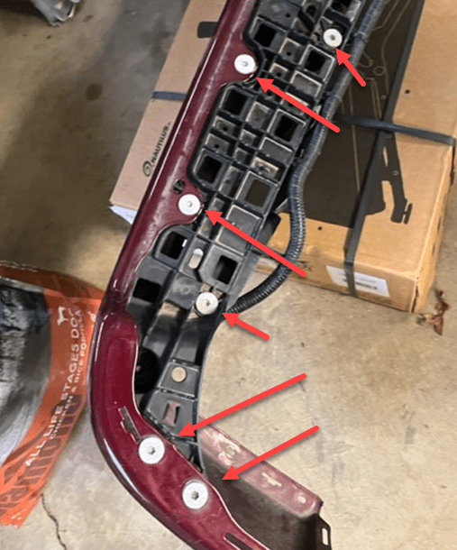

Anyone had the pleasure of replacing / repairing their rear bumper comp? I received my painted bumper (they call it a face bar) and I need to assemble the resin molded framework and mounts to the beer can thick metal shell... :rolleyes:.. There are a series of torx cap screws and clip nuts but I am not sure about what the torque should be. I am warming up the plastic part to remove the thousands of harness clips to transfer the sub harness over and thought maybe someone with a FSM could let me know. Thanks in advance
Update: Disassembled last night, there are three sets of fasteners, on that is the face bar to the resin frame, (not so tight as they are over molded nuts in resin). 6 of them go to the bumper mounting brackets and are tighter with steel collars, and 4 more that are even tighter on the bottom side that are hidden... None of them felt like they are SPEC for a M8 so will proceed from there.
