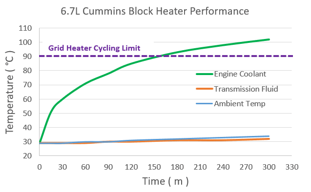

I would not worry too much about it, do your annual service (if less than 15k miles/yr) and use a good filter, I use the higher grade fleetguard but may switch over to the Donaldson that John uses if its that much better. :D... If you are using the 5w/40 syn (since you are in AK) it is all weather and you should not have any issues with cold starts.. use the block heater when really cold.. I did a study when I put my new cord in and its the most bang for the buck to only plug in for about 1.5~2h.. (amb was 29F though)... not sure what the thermal response is at say -20, but I'd assume its also initially fairly steep as I saw the first 30min.
