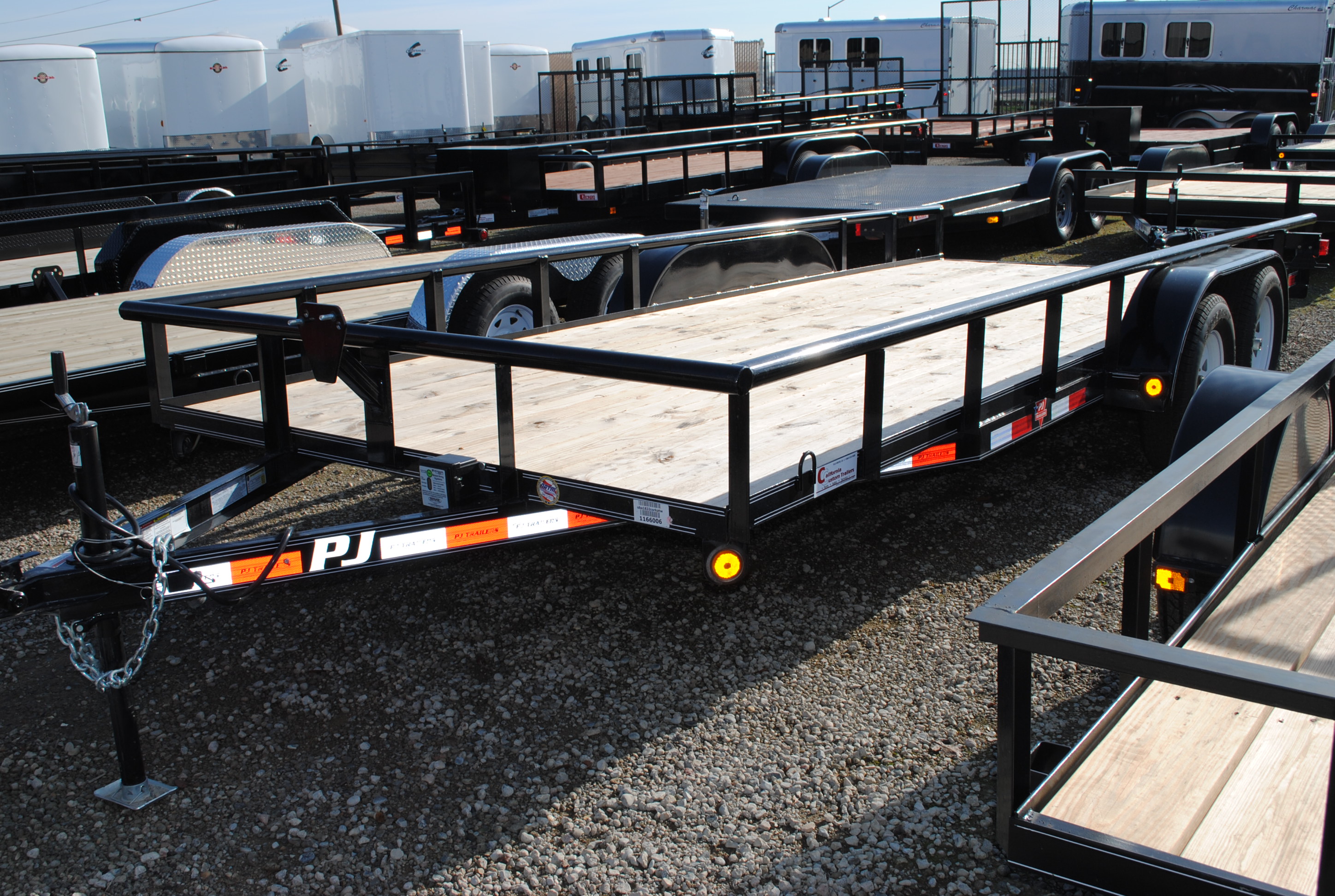

I really liked the Big Tex trailers, a lot. They're priced like gold in my area so i'm a little concerned about getting some of the money back. The PJ's I looked and were nice as well. So far the best deal I can get is on this one. He can do $2,860 out the door and throw in a spare tire. Is this capable of hauling a car? I'm not a real big fan of the rails, i'd rather put them on if I need it rather than having them permanently.

Just a thought on your "this one" trailer (the PJ with the bar rails all around). The trailer would probably be all right for your jeep, but would not be suitable for smaller, lower cars. You would not be able to open the doors when you get the vehicle on the trailer.
When I had an older motorhome, I bought a flatbed trailer for hauling my Subaru wagon behind it. I didn't have the rails but the door opened right where the fenders stuck up on the sides. The fenders were just high enough to obstruct the door from opening. I had to put 2" x 10" planks down to drive the car onto which put the doors just above the fenders. Something to think about if trying to resell the trailer.
Yeah I was thinking about the rail issue and how that would play against trying to sell it and not be one dimensional. I think I'm just going to buy the cheapest one they've got that does what I need it to do. I'll take what I've learned here and keep it with me for when I buy one for me to KEEP. They have a couple Carson's I can get for $2300ish otd, that may be just what i need.
