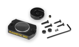

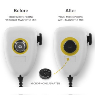

MAGNETIC MIC
https://magneticmic.com/

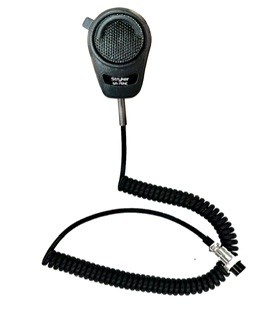

Stryker SR76 Mic Audio
The only reason to pay the Stryker premium is that legendary audio. No need to ask the operator what radio he’s running.
To that end, the re-birth of the Palomar SL-41 has arrived:
https://strykerradios.com/product/stryker-sr-76-noise-cancelling-microphone/

Best dial-in is with a separate radio in backseat to which one connects power-only, no coax. Use a headset to listen to self as mic & radio adjustments are made. (Talkback won’t work as it intercepts the audio prior to TX).
Keep radio levels tuned down (power, etc). Start from bottom and slowly work one’s way up.
The WWDX link is some of the guys who dive deep on every aspect of radio performance.
In mic review or comparison videos one notes mainly the plosive P and sibilant S. Getting those “turned down” while afterwards (with this mic) being able to find a suitable tone for one’s voice will cause this radio rig to stand out even among 955s.
Wind/Breath control, then the Sound.
Test:
https://ethos3.com/microphone-test-phrases-every-presenter-should-know/
The Radio is GTG. Now get TX audio to where How you’ve said something is clear-as-a-bell.
The testing is for any microphone chosen.

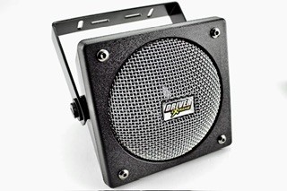

Extension Speaker
Driver Extreme DRX-901

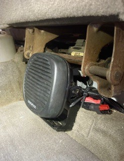

There’s no way to fully capture faint/weak signals via NRC without a quality speaker. This location can be modified to fully underseat given clearance (a Kenwood shown).
Firing into the footwell is more than pleasant and avoids airbag type problems.
https://www.bobscb.com/shop/product...e-Mesh-Grill-15-Watt-Communications-Speakers/
https://www.bobscb.com/PDGImages/V212/dx901-gif.gif
This level of audio fidelity in a mobile speaker hasn’t been matched. Yes, it matters. Next to nothing changes the experience of CB as much as the right speaker. The one built-in tells you the radio is working and that’s all it’s good for.

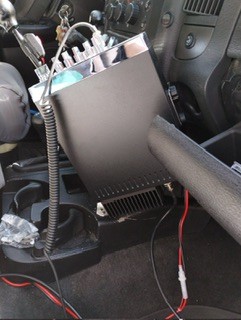

I really like your mount solution.
At the same time, if you can work in some wedges of Sorbothane to cushion against vibration, it’d put you miles ahead on reliability/longevity. Brace against shake and isolate from vibration.
