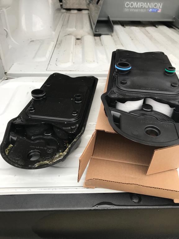

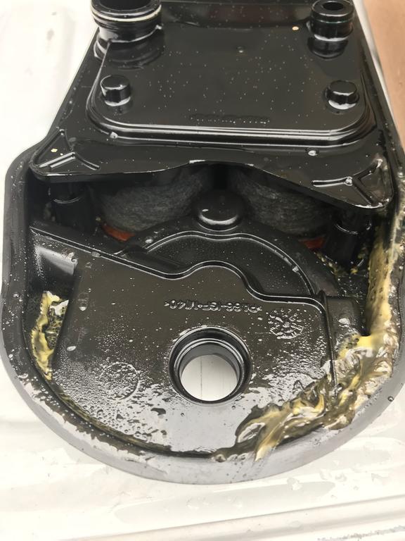

Sludgy looking and heavy with oil glad I changed this earlier than the required 67,500 interval.

I was very suprised and glad I looked at it early additionally a couple of years ago I posted here about the teaspoon or so of oil sitting in front of the turbo wheel between oil changes.
Not sure which oil you're using, but it does look like a lot of paraffin is present.
Keep in mind that the chime will still show up a few thousand miles from now...
Which oil do you use and what is your oil change interval. As for paraffin, It's in the diesel. But can also be in conventional oil.
Oil used is valvoline premium blue 15W-40 conventional and mopar or fleetguard filter.
I never hit the 15,000 mile interval always 6 months first which is typically around 6-7k.
I do blackstone oil analyst once per year usually towards the end of summer.
I usually have a heck of a time finding the valvoline blue in stock and have been thinking of switching over to rotella conventional just for convenience.

Interesting, I just had to replace the CCV filter on my '14 too! I didn't see any of the Milky looking material but the filter was completely saturated with oil, and I was starting to see oil in the intake tube.
I just turned over 57,000 miles.
probably moisture making that milky looking emulsion. I've often wondered if you couldn't soak that breather assembly in some type of detergent and re use it? any thoughts on that

I’m not concerned at all, the past couple of weekends I have been doing the 60k maintenance and curiosity got the better of me so I inspected the ccv filter and was suprised comparing mine to photos of others I have seen so changed it. I figured some here would enjoy the photos.
condensation. hot engine, engine cools off, moisture laden air is drawn into crankcase thru breather system as engine cools off. moisture accumulates, gets heated and sometimes mixed with engine oil due to heat and pressure... if the end user doesn't run engine long enough to cook off the accumulated moisture it begins to accumulate.
