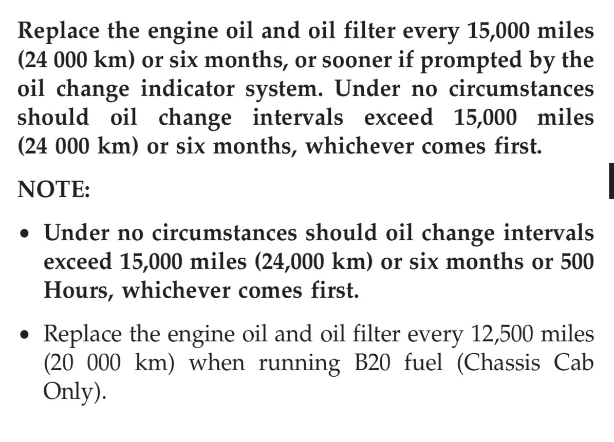

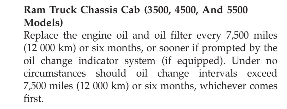

Is there a way to reprogram the computer to change the interval mileage between oil changes? Truck is 2012 4500, 6.7 CTD. Last truck was 2013 6.7 and last change was at 12k miles, not 5k miles. why the difference? Or should I just keep my own mileage records?

Because 2012 was a different engine design and was harder on oil.

You are chasing pennies while risking a $10-20K engine. If you want to extend the oil drain interval you need to do UOA and you will likely find that the mileage the computer says to change it at is correct. The 6 months is debatable esp. out of warranty, however, when your engine was built Biodiesel was generally less than 5% at the pump. It's higher now in places or at the 5% minimum. This fuel change contaminates the oil and calls for more frequent oil changes as "now" the newer years note with B20.
