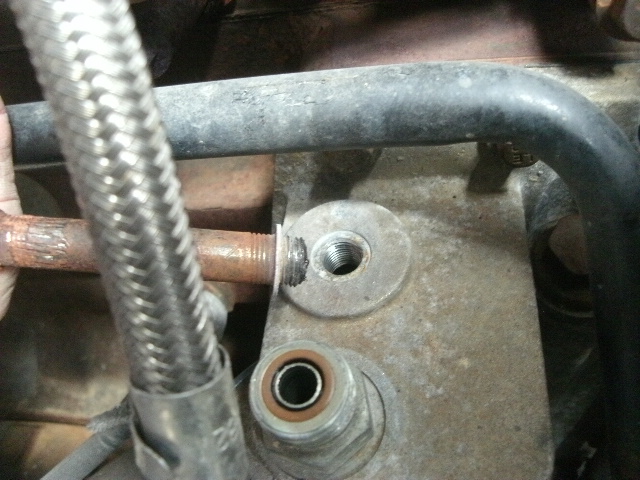

My truck see's relatively light use. I haul a camper in the summer and once in a while a vehicle or materials on a trailer. I park it all winter when snow flies and road salt starts getting laid down. I will heat it up and run it up and down the non salted side roads here twice a winter. Just to move some oil around. And since I am not doing long oil change intervals, I figure just changing it out is better than the gains from the bypass filter. Plus that 4 thread engagement on that steel 1/4 nipple did not leave me feeling like it was a solid install.
