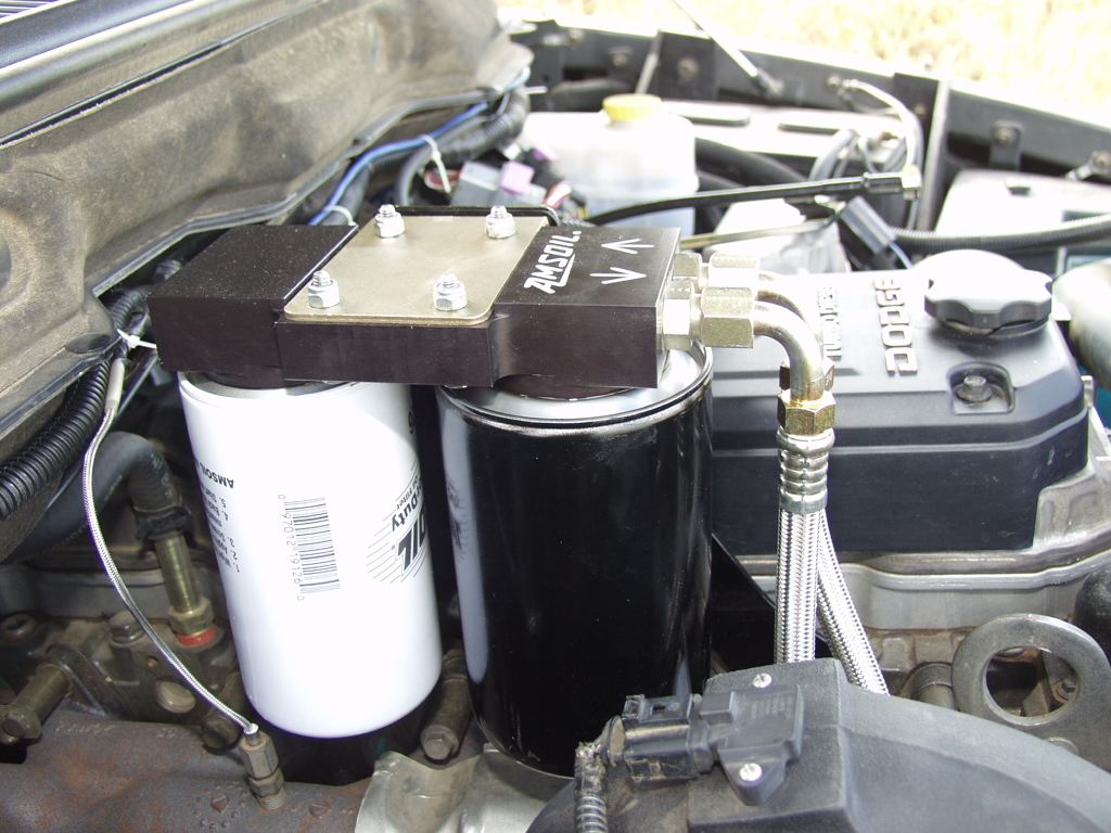

I did the remote dual filter unit on my truck. Get the Amsoil unit and their remote filter location unit to send your oil to the remote unit. I plumbed mine with 1/2" hydraulic lines. Hard part was making a skid plate to protect the filters which are located under the passengers floor broad on the frame rail. I know that it wasn't needed on our trucks with the newer oils and filtration. I wanted to have extra oil in the system and the filtration is a bonus of the setup.
Here's link to pick before I changed out the lines. Didn't like the original lines I had plumbed. https://www.turbodieselregister.com/threads/oil-relocation-kit.270735/page-2#post-2667495
Back in the day 2005 there was a lot stuff made for the 3rd genners. I'll try to post the pic of my setup.

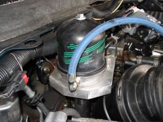

https://www.alliedreliability.com/spinner-ii-oil-cleaning-centrifuges
Then something similar to HUBB 8505, but full-flow/low-restriction. (Let centrifuge get small stuff).
Plenty of reading to do (example):
https://www.turbodieselregister.com/threads/fleetguard-centrifugal-separator-ch41102-anyone.227434/
I think most wind up with something simpler.
https://4wdmechanix.com/tag/frantz-filter/
