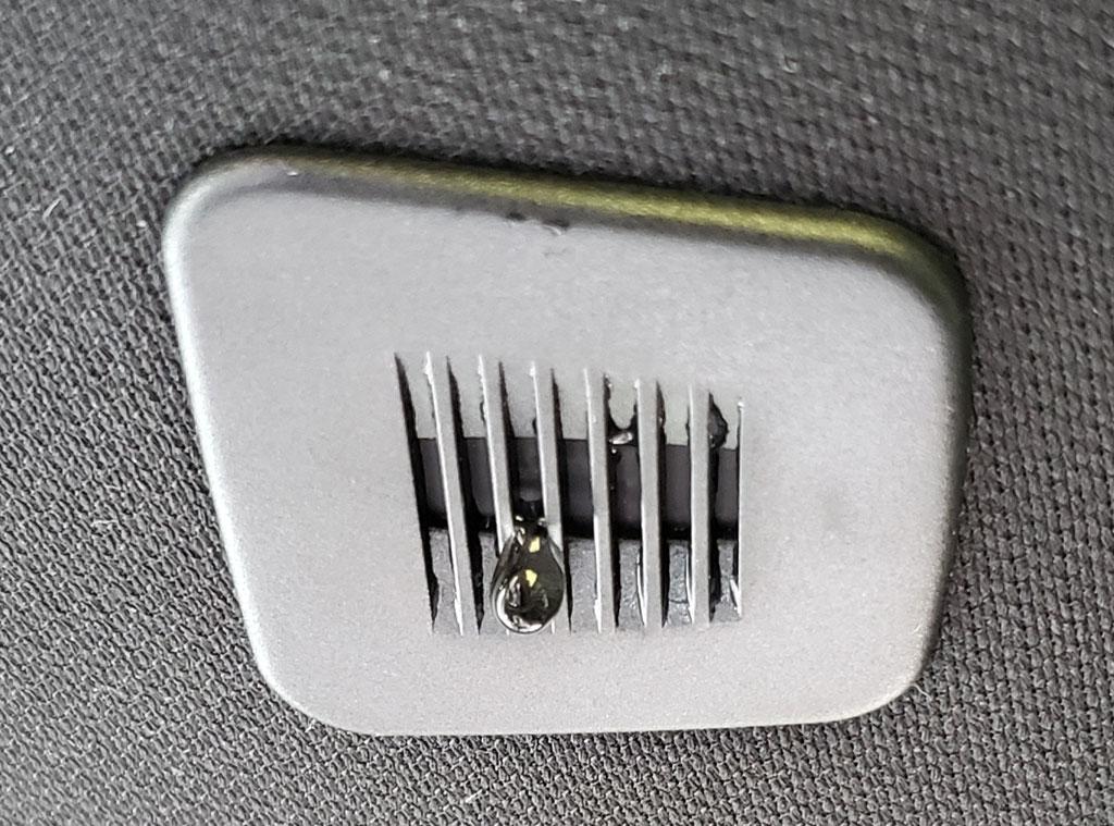

Been noticing fogged inside glass recently and found wet at back under sliding window to bed. tightened up the screws holding the bed/stop light combo. Leak stopped. After several hard rain days, noticed the front drivers side window fogged again. Found drivers seat wet and drip from the little (unknown for what) vent above drivers seat. I checked the clearance lights (they had been replaced under a recall) and the XM antenna seal and all look okay. Any ideas?

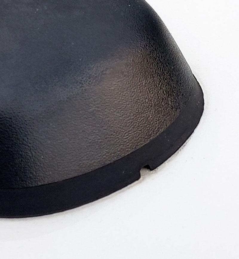

I'll take a closer look when the rain quits but from the casual inspection, they look fine. They were all replaced 10 months ago by the dealer. If they cracked one, it should be rather large to allow as much water as I'm seeing. Maybe one of the lights is not tight at all. On the back of the XM antenna seal, there is a small square cut (as in factory seal opening), but it is also very small.

I almost think it depends on how the truck is parked (angle). Pretty sure not the clearance lights. All are tight and do not appear compromised in any way. Microphone? Always wondered about that small fixture above my head. Guess the Chi-Coms are listening. Hell, they can probably drive the truck via my cell phone! What is so irritating is I have a Towncar with a leak getting to the passenger side rear floor. These kinds of leaks can drive one nuts. When ever it stops raining, I'll get a better look.
