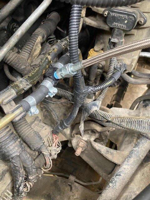

I ended up basically taping into the small rubber section of the fuel line from the filter to the cp3 with the aluminum fitting below.

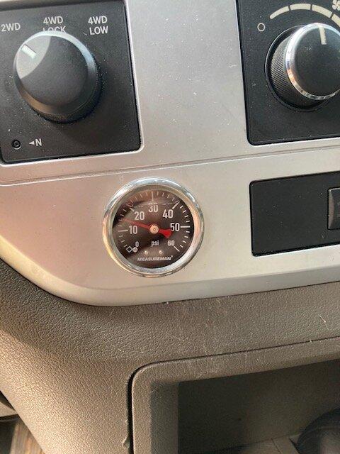

From there I routed a line into the cab and connected it to the small mechanical fuel pressure gauge, also below.
It mounts where the circular 12v outlet is, below the electronic 4wd selector. I just popped the whole trim piece out, removed the 12v outlet, stashed the connector back in the dash, and drilled the hole out to 1-1/2". I ended up having to sand it a bit to get the gauge to fit, but it ended up being a snug fit, and in my opinion, doesn't look too bad. If you're tall (like me) it can be a little difficult to get an accurate reading at a glance, but that's mostly due to the angle.
It sucks that there isn't a 0-30 psi gauge, because I tried the 0-15 psi gauge first, and my lift pump is putting out ~17psi at idle and inly drops down to ~13-14psi while driving (not sure if this is an issue, still trying to figure it out. doesn't affect starting/stopping/driving from what I can tell so far).
