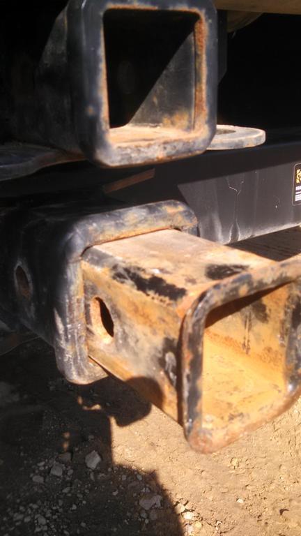

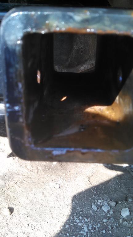

After only a few months of being in, my 2 1/2 to 2" receiver adapter was very hard to remove. Took a hammer, crow bar and lube to get out. It was damp inside the bottom of the receiver and the whole thing was quickly getting rusted. I am going to leave the hitch and adapter out from now on because the adapter traps moisture. The factory and the Curt HD hitch both already need some touch-up repainting.
