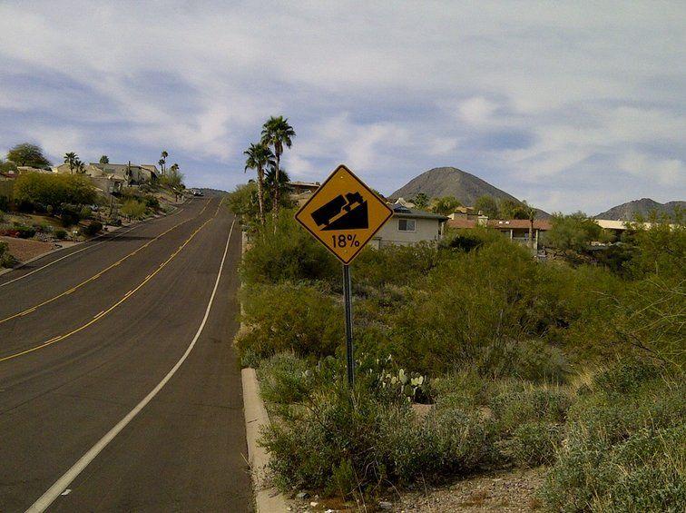

Towing a 24-28' cargo trailer around the 121 degree summers in Arizona stuffed full of auto parts and tires. Add to this mountain grades that go on for miles. Mountain Grades starting at 7% up to 18%. Literally uphill both ways on a delivery route we had.
