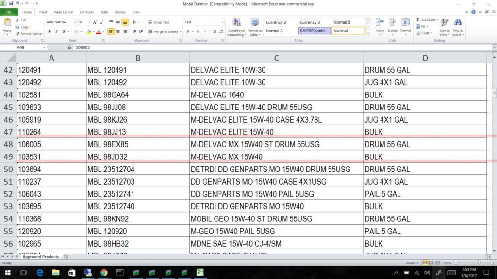

Mobil just switched me over to CK on my Delvac order last Friday. They have superceded the CJ to CK.
I think Mobil still offers CI-4, trouble is that the only packaging available is 55 gal drum or bulk deliveries...
http://mobil.cosan.com/sites/default/files/produtos/mobil_delvac_mx_15w-40.pdf
