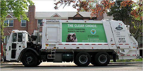

We've just been assigned this truck to babysit. Supposedly it was $700,000. We didn't buy it-- YET.
