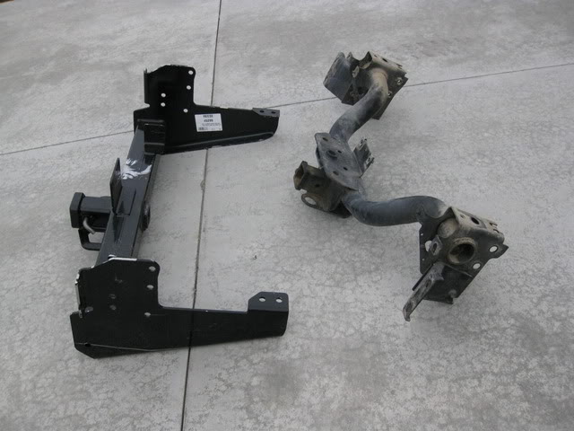

My build sheet showed the same. Hitch was welded to the cross-tube and bolted to the frame.
Here is my OEM hitch and the Reese 45299 I replaced it with.

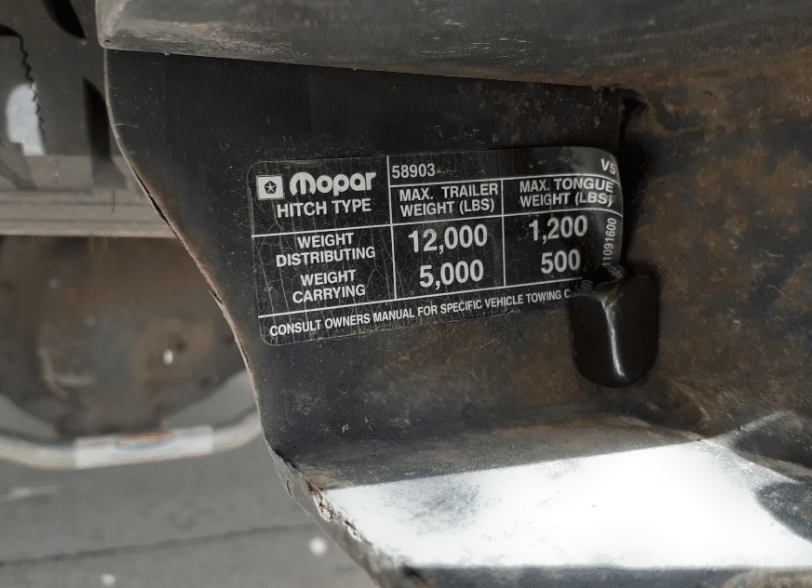

The hitch receiver on my brother-in-law's 2003 2500 4WD is also a Class IV rated at 1,200 / 12,000.
However, the sticker on the hitch shows some significant limitations when not using a weight distribution hitch. It seems that the 2004 and newer models don't display the sticker. Maybe the rating is higher on the newer trucks, but I would want to know exactly what the rating is.
- John
- John
The requirement for WDH was quite low on the 03-13 hitch.
After seeing what is being referred to as welded on, I retract what I said earlier. My early 04 hitch is welded together as one piece from the factory, but bolted to the frame as one unit.
