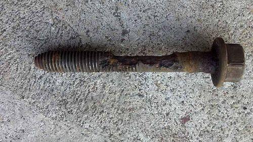

I went through this a couple of years ago. What you are describing sounds exactly what I had going on. it took me 3 months of looking/checking EVERY part on the front end of the truck numerous times before I found out what the culprit actually was and that was just found by checking the frame cab mount bolts by dumb luck. Pulled 'em all out 1 at a time and 3 of 'em were almost rusted through and the bore of the isolator was packed full of dirt and rust. replaced the rusted bolts and cleaned out the isolators and haven't had a noise/clunk since.
Good lookin' bolt , eh? IIRC there are 6 total under the cab and 2 more under the front of the front fenders (8) total.
