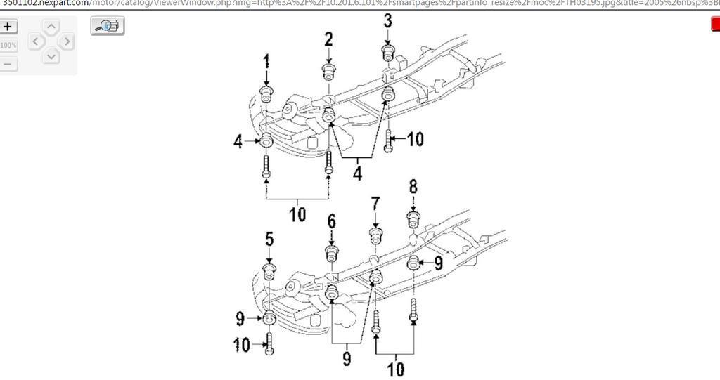

Anyone have a part number for the bolt or the bottom isolator attached to it?
Dodge is having a hard time finding it in the part catalog. They keep telling me it's a M8x1.25 x20..... NOPE :)
Are they coming up with 6501557???
Thanks Mike!!
What is the part number for 4 or 9? Why are they different?
I am guessing they are what fell off with the bolt.
From everything I have looked at while eating lunch I don't think there is anything else. #4 and #9 are the lower mounts themselves depending on truck configuration (Reg or Quad Cab).
Is your lower mount still there???
I don't think there is a separate washer or anything.

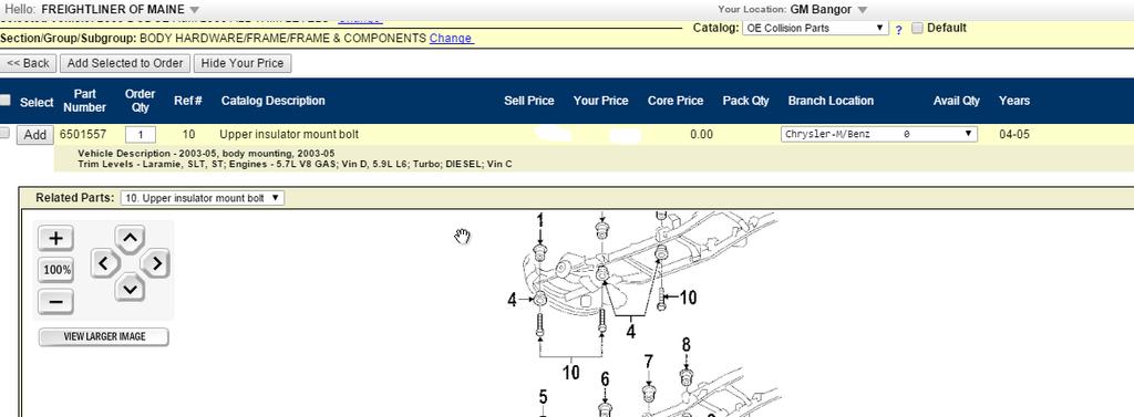

From a Dodge Dakota forum as a result of a Google part number search...
"Good luck finding them anywhere but the dealership. The part# from Mopar is 6501557.
If you want to try and source them, they are metric bolts....
Grade 10.9 Flange Bolts. Size is M12 x 1.75, 90mm length."
Number 9 seems to be the lower no matter what. The uppers vary depending on position and cab style.

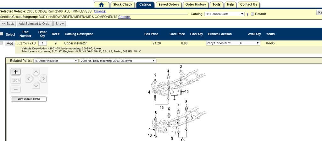

55275749AB
Verify with your dealer, this Nexiq program I'm using is accurate about 90% of the time.
