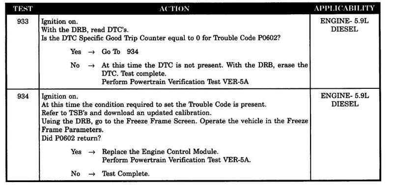

SYMPTOM
P-0602 ECM FUELING CALIBRATION ERROR (OBD II)
WHEN MONITORED
Ignition on
SET CONDITION
If any parameter is out of range for 1 second , a DTC is stored and the MIL is illuminated.
POSSIBLE CAUSES
Specific good trip counter not equal to 0
Engine control module defective
It's a two step trouble shooting tree,
