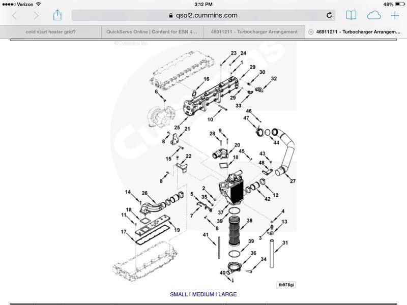

You sure are bashing people for spreading misinformation when you are the one doing it.
Per Cummins the ISB does not need any external starting aid above 10F, they classify the grid heater as an external start if aid. Not all 5.9s and 6.7s have them. There is even a part number for the spacer on the engines that don't get it.
The grid heater is functional when the motor is cold, and the intake manifold is below 66. At those warm temps it is about emissions, the colder it gets the two blend until it's 10 or colder then it's main function is a starting aid.
I suggest you do some research before opening you mouth so defensively on a topic you obviously aren't educated in.
Where is the heater in this 5.9?

I do stand corrected.
After getting a chance to talk with our Cummins rep, you are correct that the grid heaters were not supplied on all of the ISB's in equipment, it was an option, they are however standard equipment on truck engines. They were infact ordered when our equipment was spec'ed out. With that being said, he also confirmed that the grid heater is classified as a starting aid, and not related to emissions equipment.
I apologize for the mis-information.
