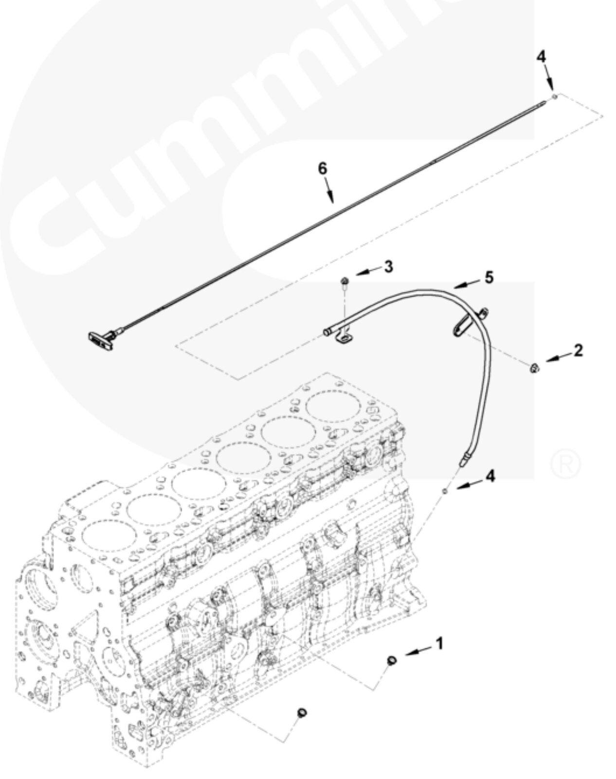

This is exactly what I was thinking. I don’t have time to look it up right now but I think your dipstick tube is two-piece and if it’s come apart or has come out of the block it could easily give you a bad reading. Check your oil, make sure it’s where it’s supposed to be on your dipstick, then drain it and see how much is actually in it.

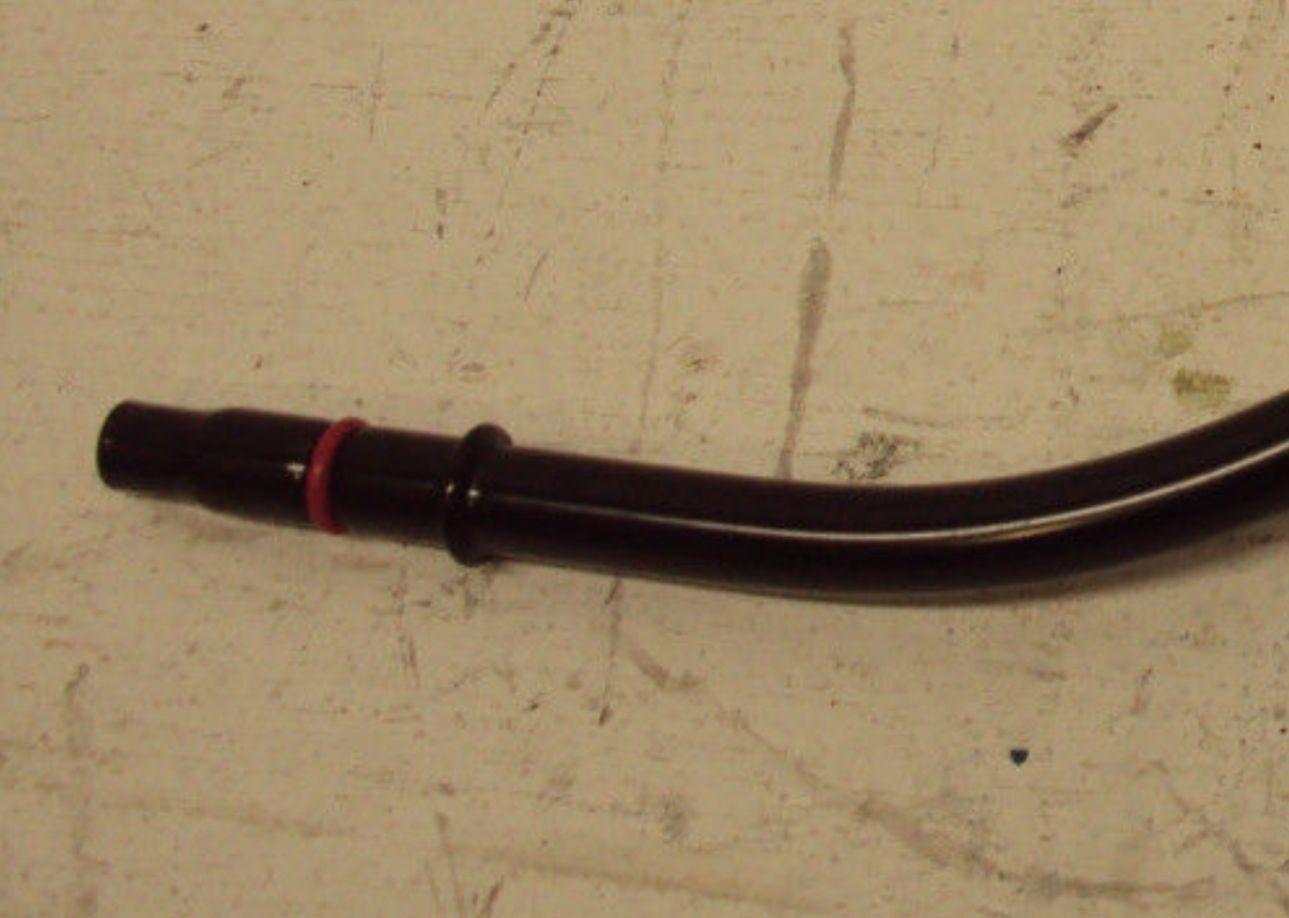

Looked it up. Your dipstick tube is one piece steel tubing so IF that’s the problem, about the only thing that could go wrong is the tube has somehow pulled out of the side of the block. It should be in the block all the way to the rib in the pic above. The red you see in the pic is the o-ring.
