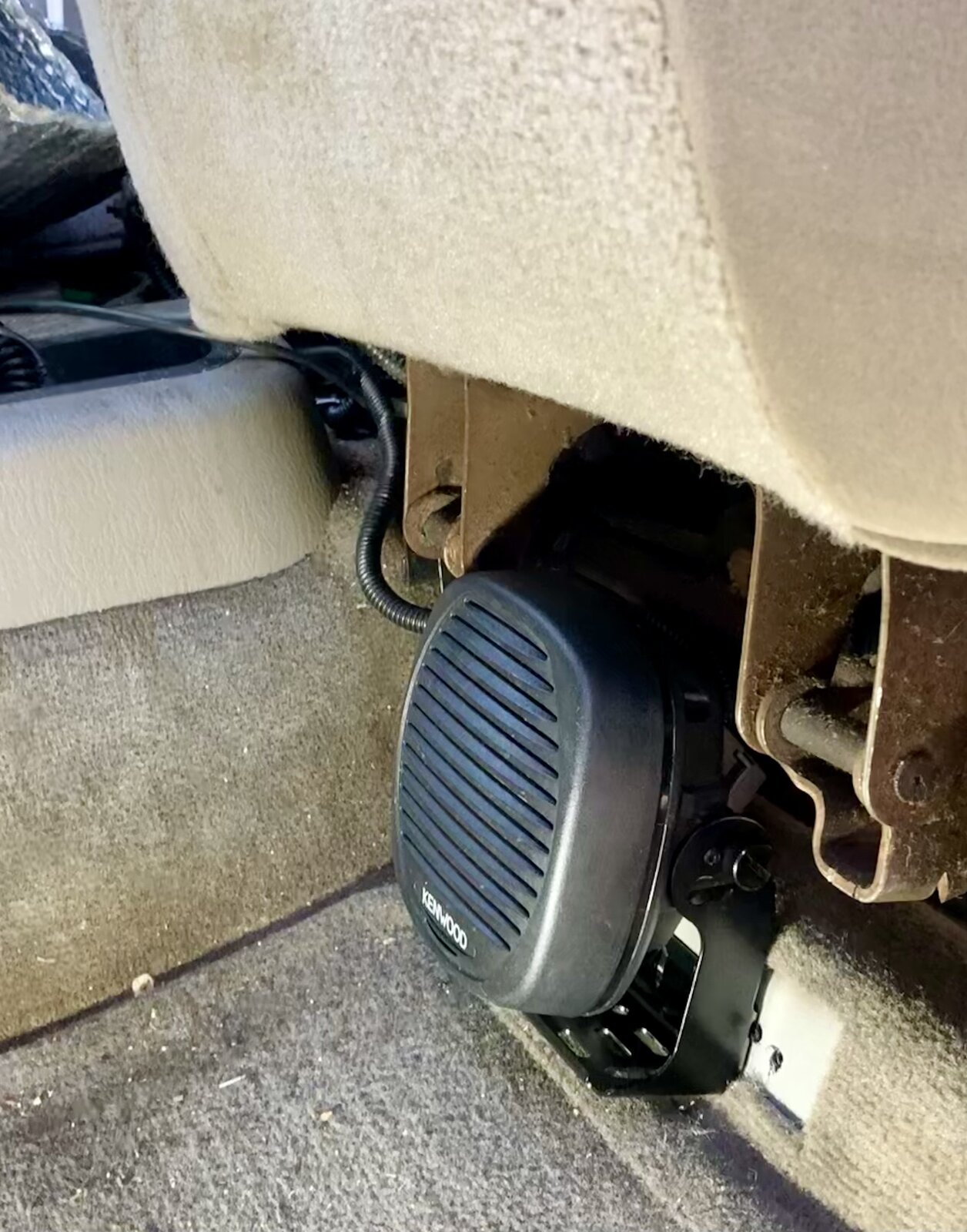

Under drivers seat firing into footwell.
This is a Kenwood KES-5 I recently installed in mine. Could go farther back. (Seat is all the way back and “up” for pic).
Location for audio is excellent.
This is a MIL-SPEC component used by EMT, Fire, Police, etc. Extreme efficiency. $65/new or $12/used. I bought a lot of (5) for $60 last year.
Several tests are that I can clearly hear NOAA (as control) across any CB I’ve had in the truck from 40-yards out with door open and engine idling. (Realized neighbors might not appreciate this).
I’d mount second behind first as experiment.
Angle as is best.
Cut carpet and then glue back over at removal.
Angle as is best.

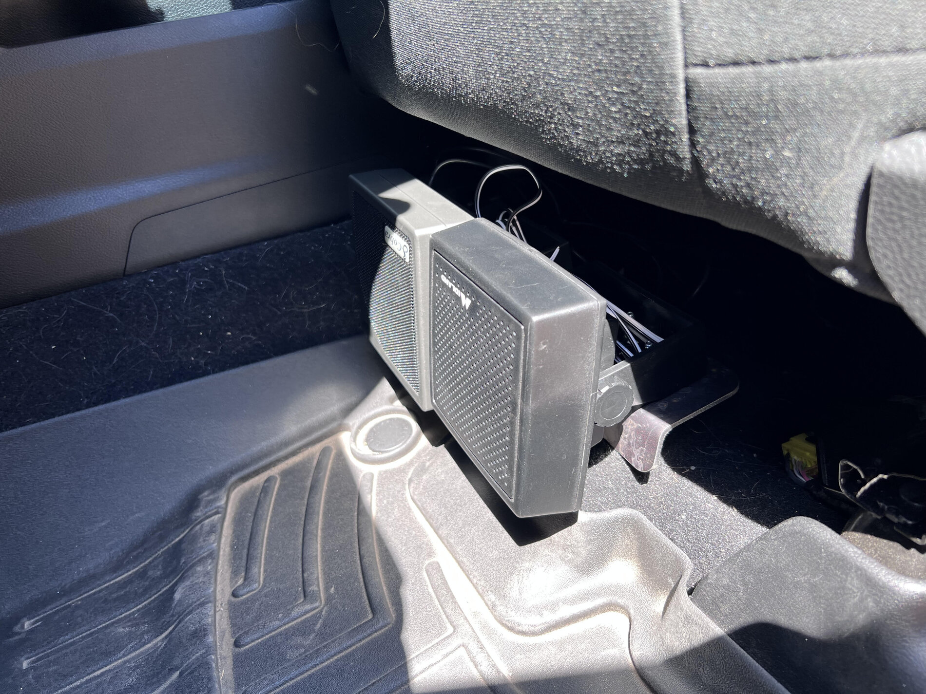

I have been toying with this idea, or one similar to it in order to work around the 5th gen design, and I may have a solution. Have to wait on a couple things and should have something soon.
so... I have been driving around with this for over 1,000 miles and I like it. I also made a single speaker unit as well, just in case..?
Now, I need to pull this one and get it coated, then finish the install on my radios. :-D
Pull the seat bolt, slide bolt through bracket and spacer, reinstall seat bolt.
It does limit forward travel a bit, but I am tall and have my seat more forward than most people that are 5" shorter than I am, and there is still room to go forward. And being 12ga steel, it will last as long as the truck.
