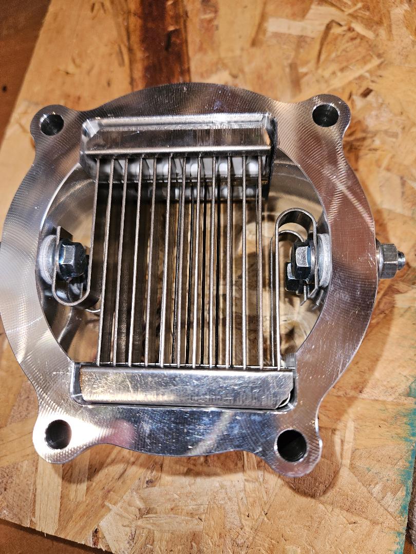

@Faceless, I've done the BD improvement grid heater kit. Love the design with heavier buss bar! It wasn't a bad job. You'll need to pull injector lines, fuel rail and intake plate. here's the thread about it, https://www.turbodieselregister.com/threads/replaced-the-killer-grid-heater-bolt.275191/
The buss bar doesn't have a nut to drop off! Will handle more current without the worry! Plus you'll be able to clean up the soot from the grid and horn. Feel free to ask more questions. We won't bite your hand and offer help and reference for what your asking.
