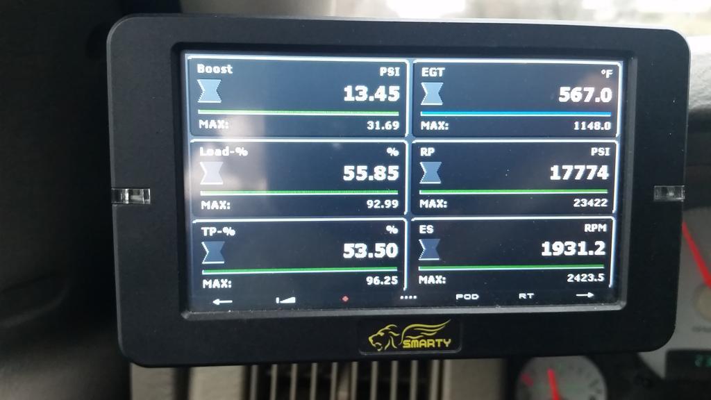

I got a log but I didn't check it out yet.
Air filter is very clean (ProGard7)
I got to do another run w/the temps @ 40* and light drizzle at 500'.
I almost missed the surging sound, Last time I easily heard it, this time I was busy watching my Touch & suddenly I realized that I was hearing a fast pulsing sound.
Maybe I'm just paranoid! :p
I'll report back in the morn when I Check out the log.
I plum forgot to watch my lift psi gauge but I expect it was 10~psi.
I wish there where a way toread the date stamp the logs stored on my Touch's sd card! {maybe they are and i dont know it] I'm not sure which one it is or MAYBE i never recorded one :mad:
None seem quite right.

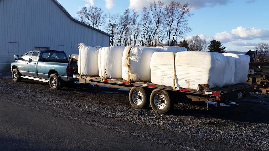

Here is a pic of what i'm hauling; 50~% moist hay bales wrapped in poly so it ferments. Yes its heavy! ;)
I hauled a load last eve, 40*f and clear. Truck ran well, ''surge'' was never heard! :confused:
2000-2240rpms/ 19000-22800rail/ 800-1000*egt/ 18-31# of boost. 3rd TC locked, In a 5 sec log. [i logged more but this was steady cruise to wot till i let off.] A lil hill i came to.
Still a lil confused but glad i didnt hear any weird sounds. I tryed to check drive psi but had a leak on my drive psi gauge set-up. 20# of boost and 15# of drive is just not right!
My lift pump psi was at 8psi wot.
