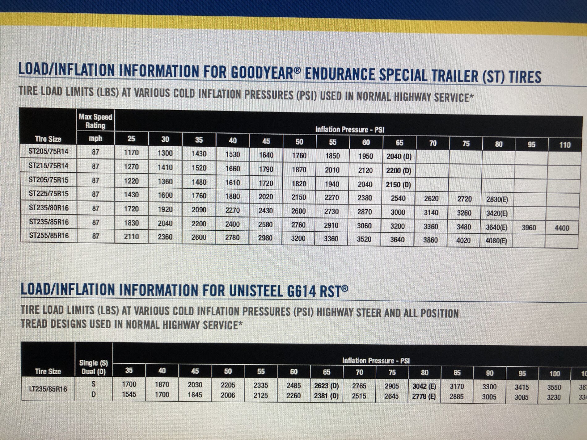

The Endurance 255/85 R16 have 4,080# capacity at 80psi or 4 tires at 16,320# that is WAYYYYY more capacity than needed for a 14k trailer. Also US Made with a STELLAR record and a 87mph speed rating.
